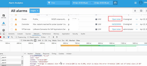

STEP #3 : Check if manual ticket creation is working, use the Developer tool
Check if you get any error or exception

b) Result from Developer tool > Network tab : when creating a ServiceNow Incident manually:
