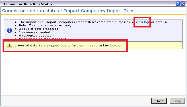

  • It is strongly recommended to use the import rule's log to troubleshoot issues. This should not be confused with the Altiris server logs (the a.log files), which often don't actually include useful troubleshooting information. The import logs can be found on the Connector Rule Run Status window and in the "Run history" section at the bottom of an import rule:
    Import logs can also be found as .xml files on the Altiris server's hard drive, which can be sent to Technical Support as needed.
    By viewing the import log, errors that occur on specific records can be viewed and troubleshooting performed. For example, the following error shows that the required resource name for record 1 wasn't found and was therefore skipped.
