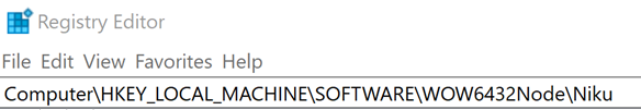

    • HKEY_LOCAL_MACHINE\Software\Niku
      Note: You may need to drill down to the Wow6432 folder to get to the Niku folder depending on your bit level: HKEY_LOCAL_MACHINE\Software\Wow6432Node\Niku
      1. Expand the HKEY_CURRENT_USER folder
      2. Expand the Software folder
      3. Scroll down and check if Niku exists.
      4. If not, also expand the Wow6432Node folder and see if Niku exists there.
      5. If yes, right-click the Niku folder and delete it
        The file path in the registry for 32 bit: HKEY_LOCAL_MACHINE\SOFTWARE\WOW6432Node\Niku
