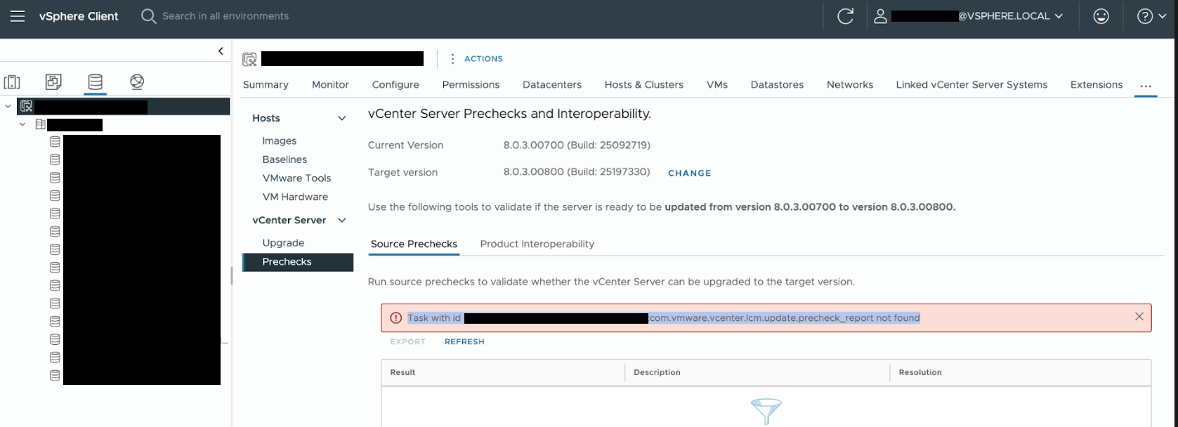

  • "Task with id <ID>:com.vmware.vcenter.Icm.update.precheck_report not found" error is seen in the precheck window

  • This UI issue is caused by the invalid URL in the update settings.
  • In the above log snippet, URL contains "8.0.3.0500" instead of "8.0.3.00500" (one zero is missing)
Ensure to enter the right URL in the settings. Refer this KB for the detailed step by step instruction.
