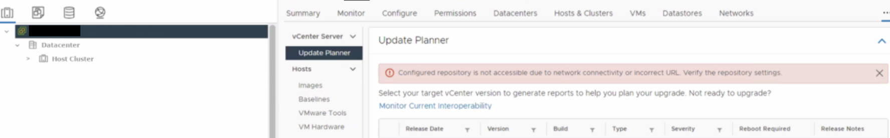

  • In addition the Update Planner in vSphere Client (https://<vcenter_fqdn_or_IP>/ui) shows a connection error:
    • "Configured repository is not accessible due to network connectivity or incorrect URL. Verify the repository settings."

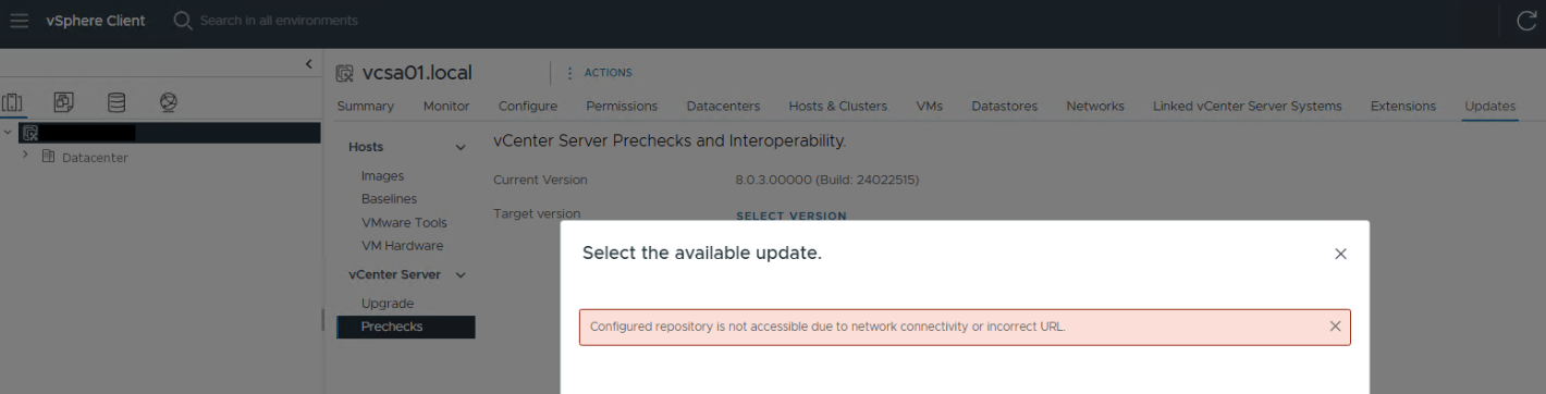

    In vCenter Server 8.x, the same error is seen in the Prechecks tab (vCenter > Updates > Prechecks):

  • This issue occurs when vCenter is still configured with the old public facing vmware.com repository URLs.
  • These download URLs are no longer active and are replaced by the new dl.broadcom.com that require specific tokens generated from support portal.
