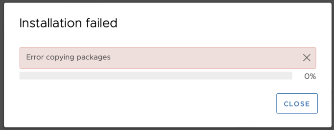

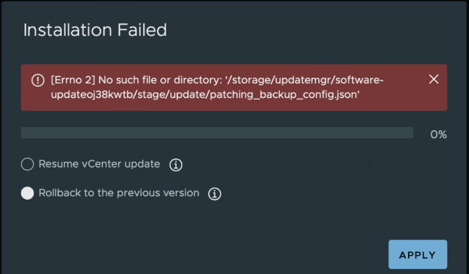

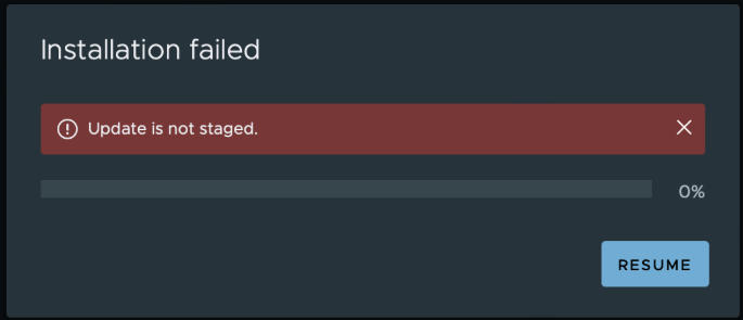

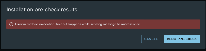

  • When attempting to patch the vCenter Server via the vCenter Server Appliance Management Interface (VAMI), the operation fails and displays one of the following errors. This issue is observed after updating the token as instructed in Broadcom KB VCF authenticated downloads configuration update instructions:
    • Error copying packages:
    • Update is not staged:
    • [Errno 2] No such file or directory: '/storage/updatemgr/software-update######/stage/update/patching_backup_config.json':
    • Error in method invocation Timeout happens while sending message to microservice:
