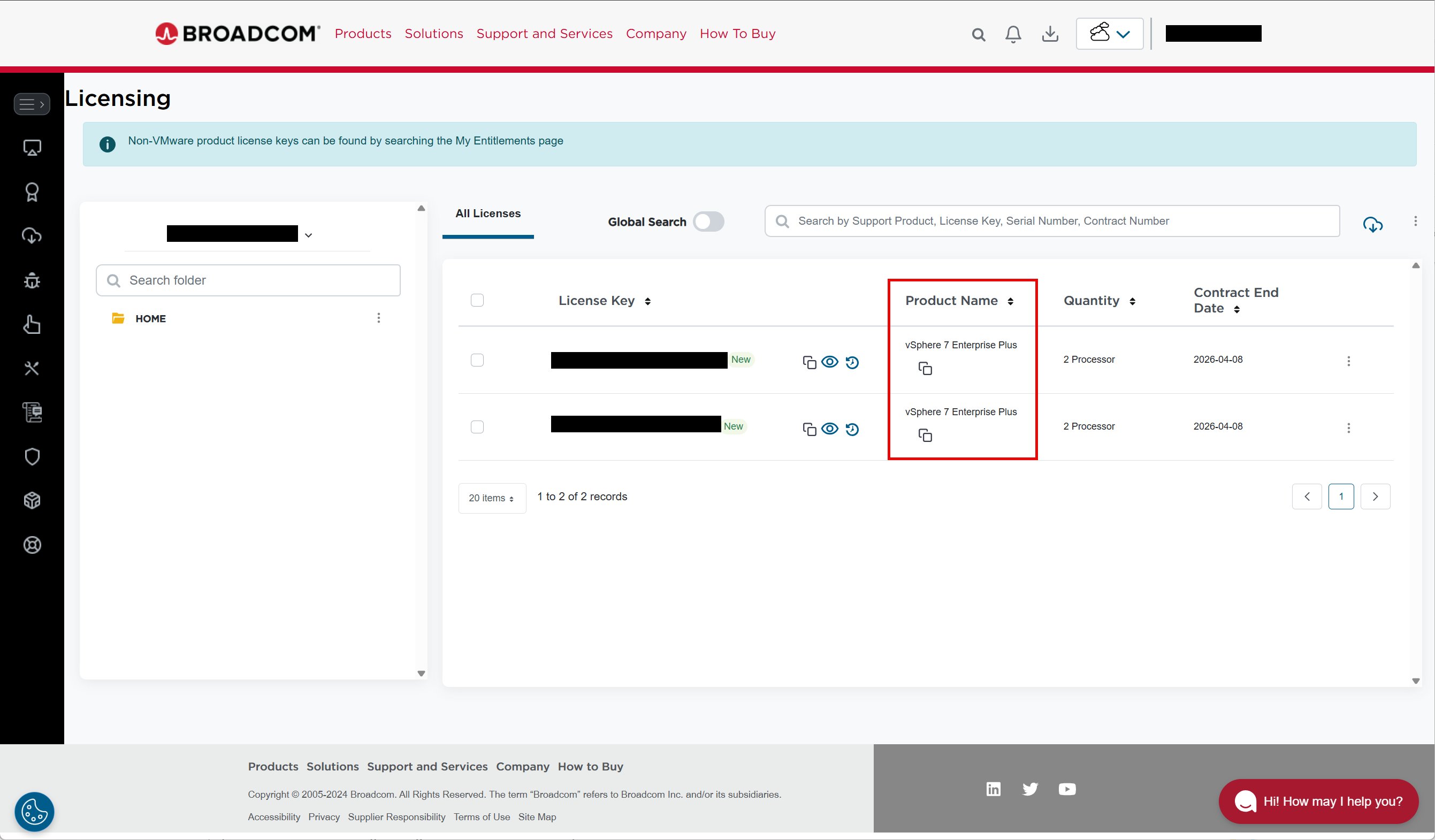

Check that the site ID tied to the token has a valid active contract.
  1. Obtain the site ID used when generating the token.
  2. Lookup the site ID in the Support Portal / My Entitlements Portal.
  3. Expand the product the user is attempting to configure their download token with and click the Licensing icon.
  4. Search for the product serial number or license key to confirm which version they are currently entitled to.
