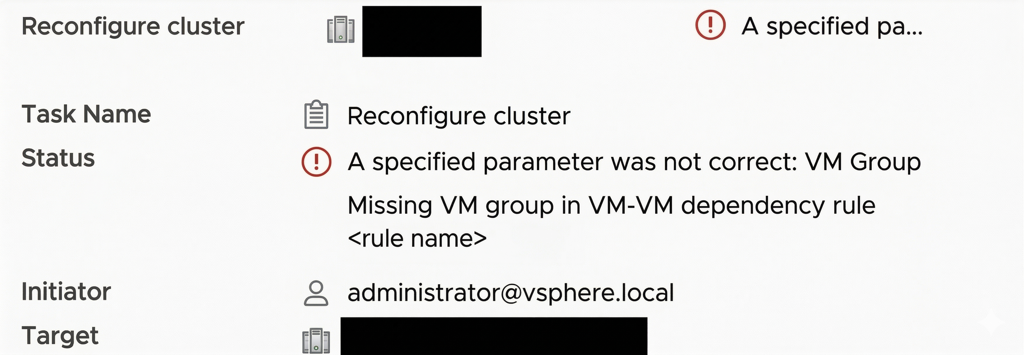

  • Error message as seen in the vCenter UI:
  • This issue is encountered when a VM/Host group no longer exists but there are Rules present that are associated to the non-existing VM/Host Group.
  • The issue can also occur if a VM part of a Rule no longer exists in the same cluster.
  • In both scenarios, the Rules are considered stale entries and cannot be deleted from the vSphere Client.
