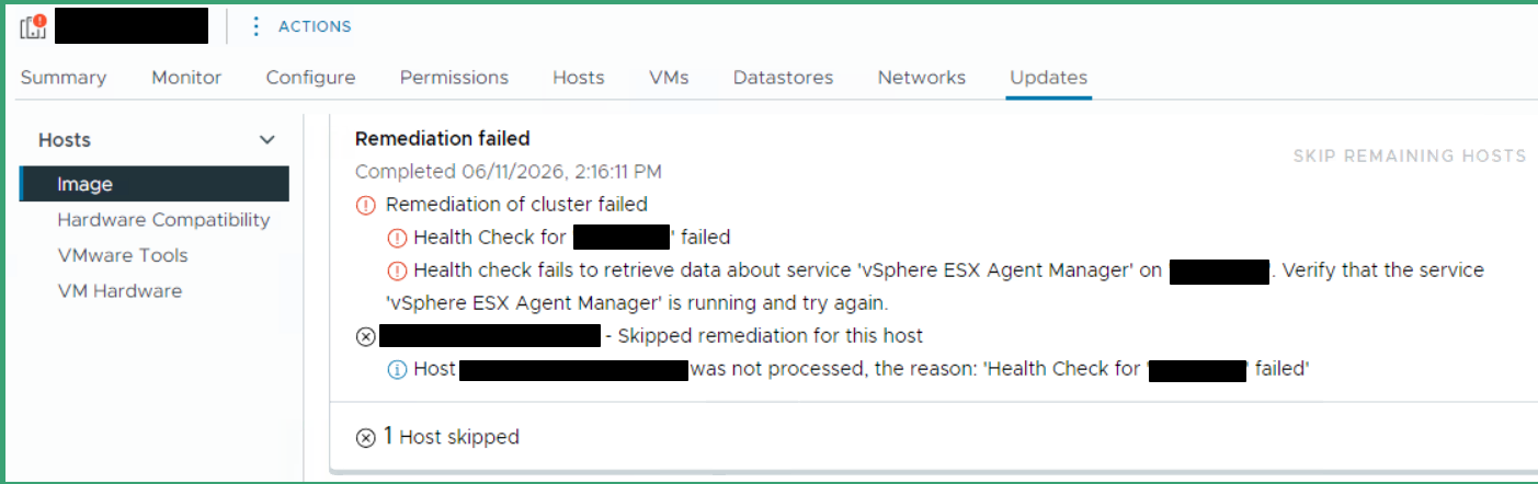

  • Remediation can fail with Verify that the service 'vSphere ESX Agent Manager' is running and try again.
