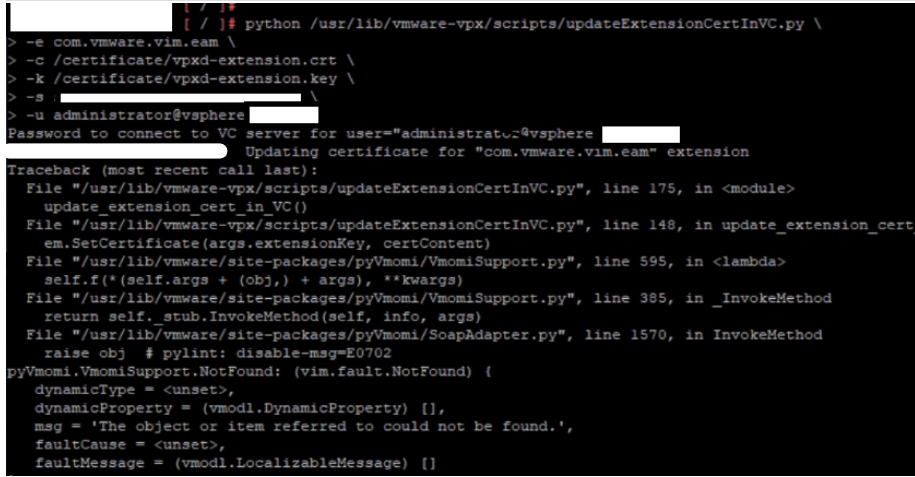

  • The issue persists even after attempting to update the EAM extension certificate using the following KBs:
    EAM "Failed to login to vCenter as extension, Cannot complete login due to an incorrect user name or password" after replacing the vCenter Server certificates
    Replace certificates on vCenter server using the Fixcerts script
    Upgrading or Patching vCenter Server to 8.0 fails with precheck error "Source vSphere ESX Agent Manager (EAM) upgrade failed to obtain EAM URLs to check against trusted certificates by the System"
    When attempting to update the EAM extension as per the above KBs, the following error is seen:
    raise obj # pylint: disable-msg=E0702
    pyVmomi.VmomiSupport.NotFound: (vimfault.NotFound)
    msg = 'The object or item referred to could not be found.'
  • EAM extension does not exist in Postgres database, which is confirmed by running:/opt/vmware/vpostgres/current/bin/psql -d VCDB -U postgres -c "select ext_id,thumbprint from vpx_ext where ext_id='com.vmware.vim.eam';"
