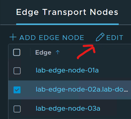

If the Display Name is incorrect follow the steps below”
1. Navigate to NSX UI > System > Fabric > Nodes.
2. Select Edge and click on the EDIT hyperlink.
3. Here change the Name to match what is in SDDC.
4. Select the Edge and from the ACTIONS menu choose "Sync Edge Node Configuration".
5. Try to remediate the passwords/rotate them from SDDC UI.
