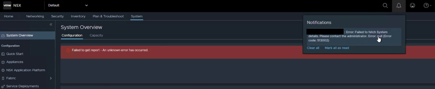

  • The NSX Manager UI displays the following error and/or the notification:
    "Failed to fetch System details. Please contact the administrator. Error: null (Error code: 513002)".
