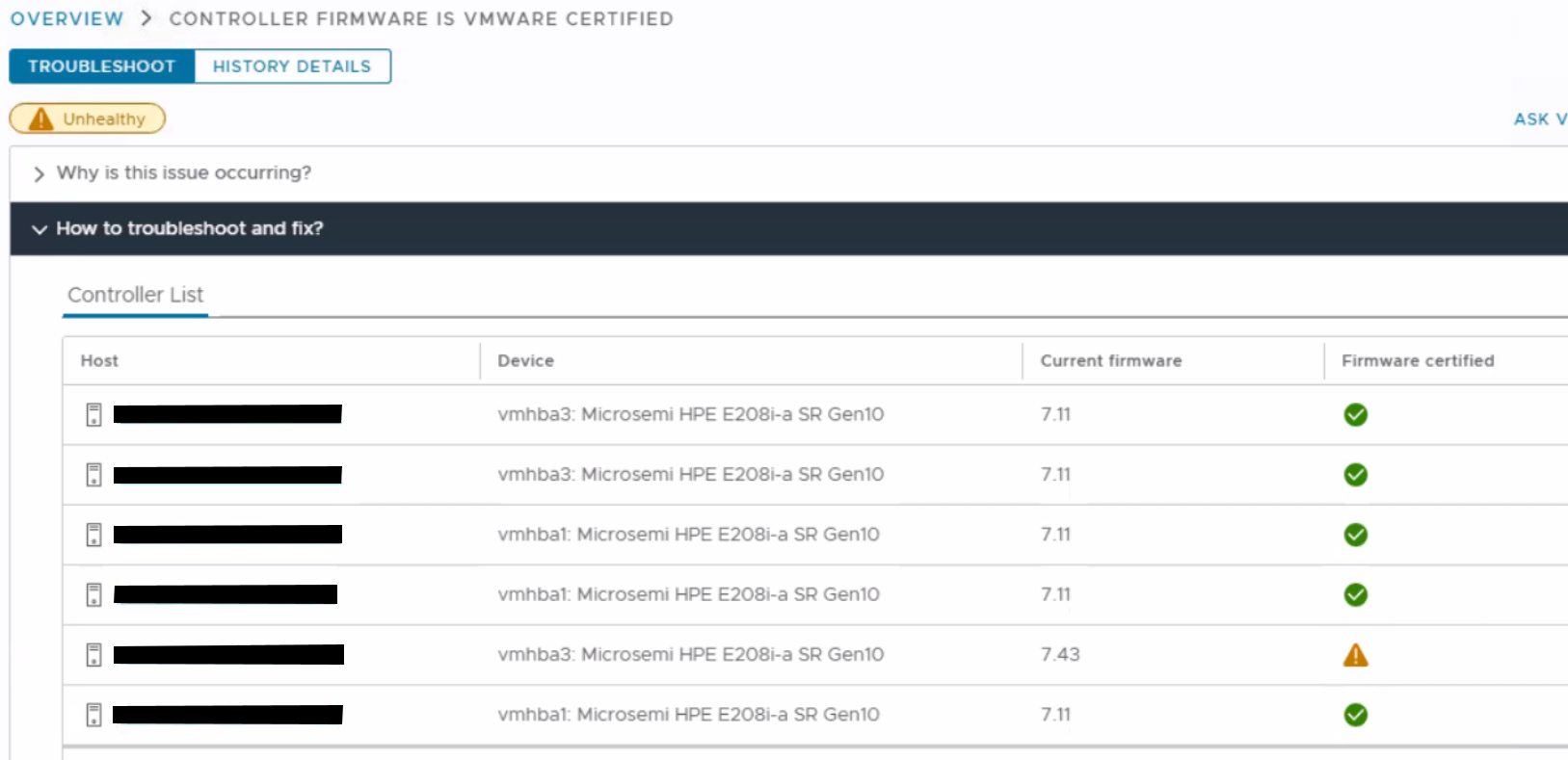

This health check verifies whether the storage I/O controller firmware/driver is compatible with the controller on the ESXi host and the version of ESXi.
If the controller is on the VMware vSAN Hardware Compatibility Guide (Broadcom Compatibility Guide) and passes appropriate controller checks, the Controller Firmware/driver Check verifies that the firmware/driver version in use is on the list of supported drivers/firmware.
If the controller's firmware/driver version is not listed in the vSAN VCG for this device and the ESXi version, the vSAN environment might be at risk.
This check might fail:
  • If vSAN cannot fetch the firmware/driver version, which can occur when the appropriate vendor tool is not installed. In this case, the status for the controller is Unknown.
  • If the Skyline Health is also reporting alerts in regard to failed checks in relation to Controller, this check also fails.
  • If after an ESXi upgrade using LCM, the newly installed firmware/driver is not compatible with the ESXi version.

  • "Controller firmware is VMware certified" triggered by the conflicting entries in the vSAN HCL DB.
If this test fails, update the HCL DB (JSON file) manually.
It is possible that the hardware or its firmware, or the release of the driver were recently added to the vSAN VCG.
Then check if the appropriate vendor tool is installed, and verify that vSAN can fetch the firmware version.
How to query the make, model, and version of your storage I/O controller:
  • Run command: esxcli vsan debug controller list
For upgrading the firmware of I/O controller via vSphere Lifecycle Manager: The Firmware of your I/O controller can be upgraded via vSphere Lifecycle Manager.
If you cannot determine storage I/O controller information, contact Broadcom Support.

  • VMware discontinued the requirement for installation of PERCCLI and STORCLI, starting from ESXi 7.0, an 'Unknown' will be displayed in the firmware version field even if those tools are installed. The display of 'Unknown' will NOT trigger any Health Check warnings.
  • The alert "Controller firmware is VMware certified" or "Controller driver is VMware certified" might also come up, if the controller firmware or driver version does not match with the Broadcom Compatibility Guide.
    • In this situation, we would need to correct the firmware version by installing the supported version listed in the Broadcom compatibility guide. Take help from the hardware vendor if needed to update the correct firmware version.
    • After rebooting, the alert should not show up anymore.
