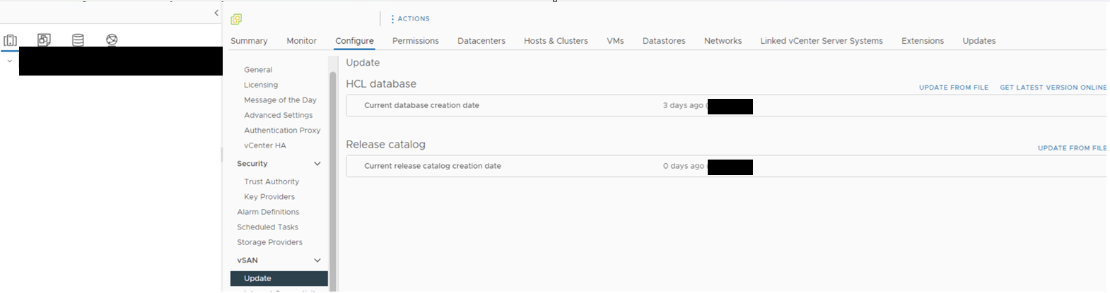

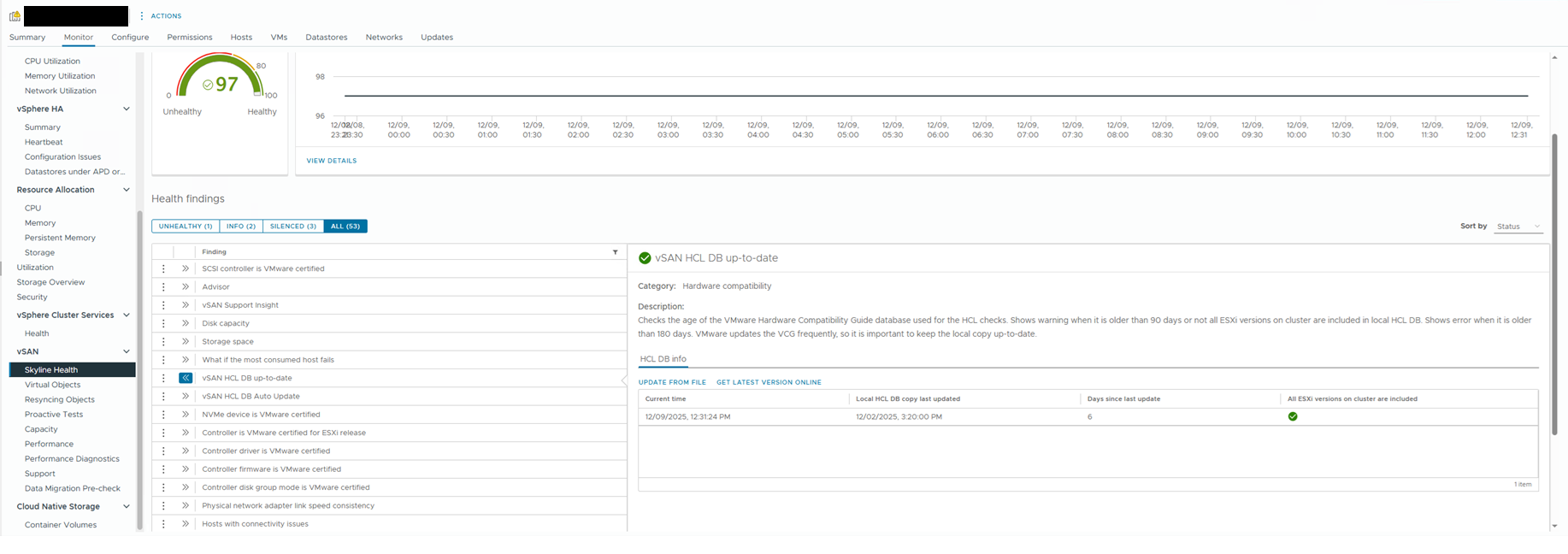

  1. Log in to the vSphere Client with administrator credentials.
  2. Navigate to Cluster > Monitor > vSAN > Skyline Health > Health findings > vSAN HCL DB up-to-date.
  3. If no internet access is available, click Update From File.
  4. Upload the all.json file (downloadable from https://vvs.broadcom.com/service/vsan/all.json).
  5. Click Retest.
