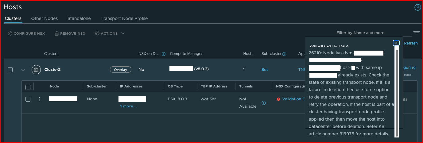

Install Failure/ Validation error: While preparing an ESXi host as a Transport Node, the following errors are seen:
Node <node-name> with same ip <###.###.###.###> already exists
Or
Error: General error has occurred. Discovered node with id:<Discovered Node ID:host-###> is already prepared having fabric node id:<Transport Node UUID>.
 Or
Node <node_name> with same ip <ip_address> already exists. Check the state of existing transport node. If it is a failure in deletion then use force option to delete previous transport node and retry the operation.
Note: node_name is the last part of the resource path as found when you click the hamburger menu on the host in System, Fabric, Host and select Copy path to Clipboard. For example here it is #######-########-9c7e-436b-8660-############host-## from this path is /infra/sites/default/enforcement-points/default/host-transport-nodes/########-########-9c7e-436b-8660-############host-##.
Note: Transport Node UUID is the value retrieved when you click the hamburger menu on the host in System, Fabric, Host and select Copy ID to Clipboard. For above, it would be ########-9c7e-436b-8660-############

To move the host out of the vSphere cluster:
  1. Make sure the host is in maintenance mode and select the host in vCenter:
  2. And move it to the datacenter level:
  3. In the NSX UI, the host will now show up under System, Fabric, Hosts, Other Nodes:
Option 1:
  1. Clicking on the Uninstall failed will open a new popup frame.
    Click on View errors to see the details in the next popup frame.
    Error message will vary depending on the actual root cause of the case:
  2. Click Cancel on the popup message and select the host by clicking the check box beside it and then click REMOVE NSX:
  3. And check the Force Delete check box on the window which pops up and then click DELETE:
  4. Wait for the Transport Node deletion to start:
  5. If the deletion is successful, the host will show as Not Configured:
  6. Once the force delete is complete, the ESXi host can now be re-added to vSphere cluster and if it has a TNP applied, it will get prepared for NSX again.

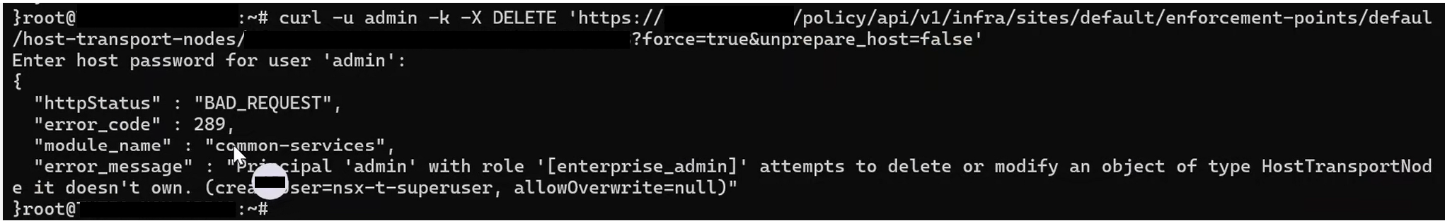

  3. For NSX-T 3.2.x and 4.x, run the following API call:
    DELETE https://<NSX Mgr IP>/policy/api/v1/infra/sites/default/enforcement-points/default/host-transport-nodes/<node_name>?force=true&unprepare_host=false
    Note: Replace <node_name> with the node ID you received in the error (see Issue/Introduction section).
    Note: If the DELETE API call fails with error code 289 stating "Principal 'admin' ... attempts to delete or modify an object of type HostTransportNode it doesn't own," you must pass the X-Allow-Overwrite: true header to force the deletion.
    Example using curl:
    curl -u admin -k -H "X-Allow-Overwrite: true" -X DELETE 'https://<NSX Mgr IP>/policy/api/v1/infra/sites/default/enforcement-points/default/host-transport-nodes/<node_name>?force=true&unprepare_host=false'
    Wait five minutes, then run the GET transport node state command again, as seen in Option 4 Step 1 periodically until  "Object Not found" is returned.
