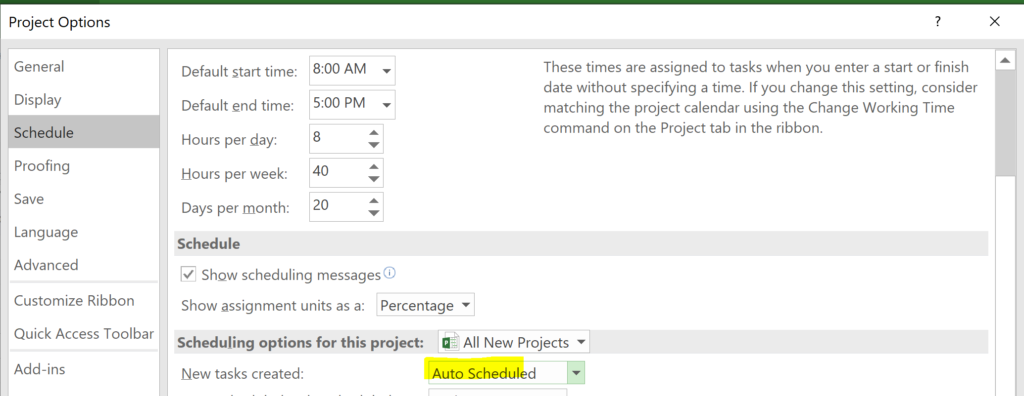

Prevent Issue on Future Tasks
Note: To prevent this issue going forward, ensure that the following required setting is made for the existing project and all new projects in MSP:
  1. In MSP, go to File->Options
  2. Click on Schedule on the left hand side
  3. Set 'New tasks created' to 'Auto Scheduled'
  4. Click OK'
  5. After initial task creation, the task can then be changed to Manually Scheduled. For more details including steps to change this, see: MSP Manually Scheduled Tasks / Milestones.
Tip: Change Scheduling options for this project from the existing project to All New Projects to then make this the default for new projects going forward.
