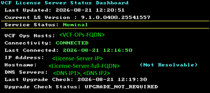

  • License Server appliance shows Connectivity: Connected , but Hostname : <licenseserverfqdn> (Not Resolvable)

vCenter Server and VMware Cloud Foundation (VCF) Operations appliance is unable to resolve the Fully Qualified Domain Name (FQDN) of the license server to its corresponding IP address.
