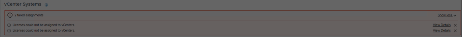

  • When attempting to assign licenses to a vCenter instance in VMware Cloud Foundation (VCF) 9.1, the operation fails with the following error:
    Licenses could not be assigned to vCenter.
