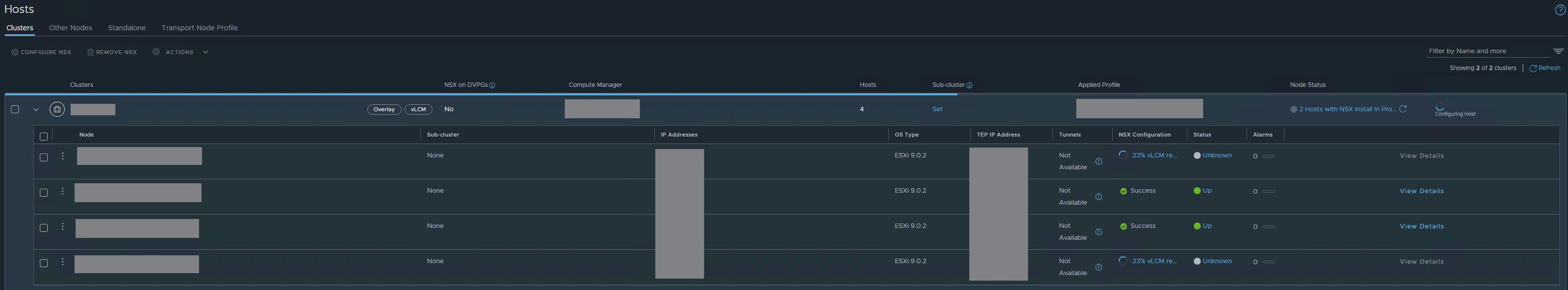

  • When attempting to prepare ESXi hosts for NSX within a cluster managed by vSphere Lifecycle Manager (vLCM), the installation process fails or stalls
  • ESXi transport node preparation is stuck at 23% as in the below screenshot
