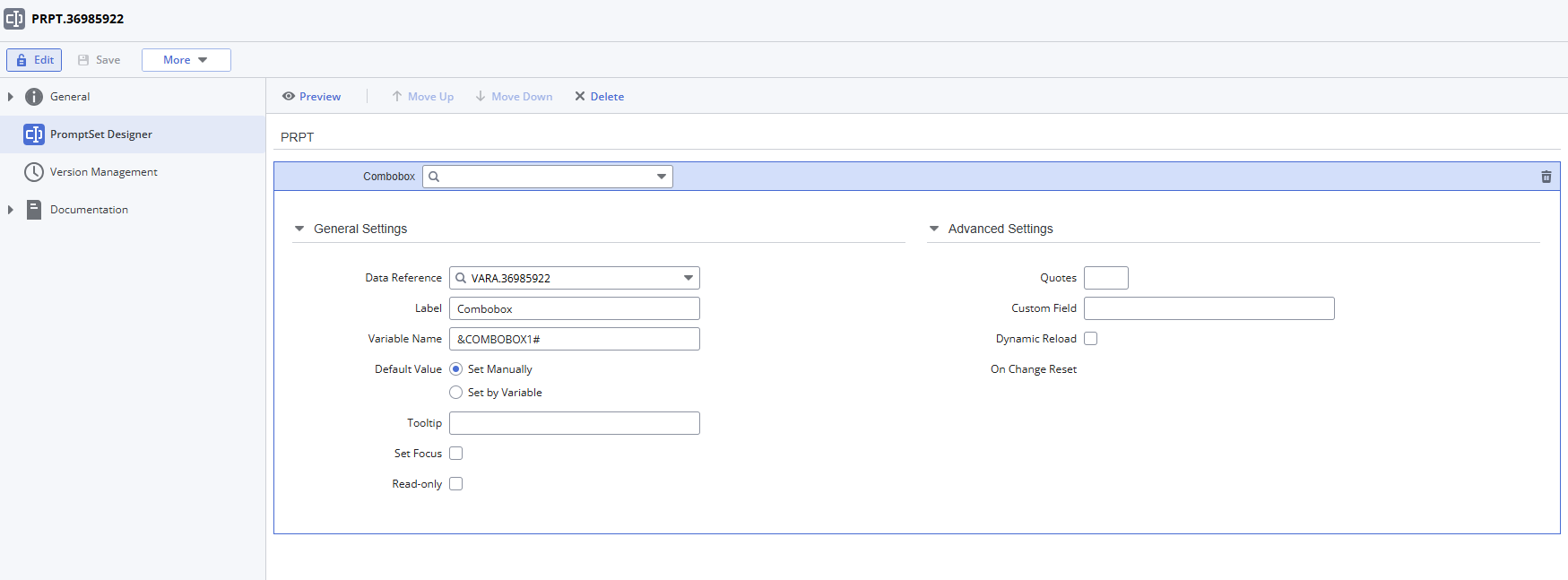

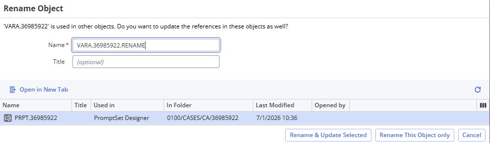

Renaming a variable object (VARA) used inside a Prompt Set does not update the variable name within the Prompt Designer, even when selecting the "Rename & Update Selected" option.
  • The VARA object is renamed using the Rename & Update Selected utility.
  • Opening the Prompt Set in the Prompt Designer displays the first alphabetical variable name located in the associated client.
  • Automic Automation Engine V24
  • Automic Automation Engine V26
The rename operation does not correctly update the embedded XUI JSON string within the Prompt Set elements. This is identified as defect DE208227.
