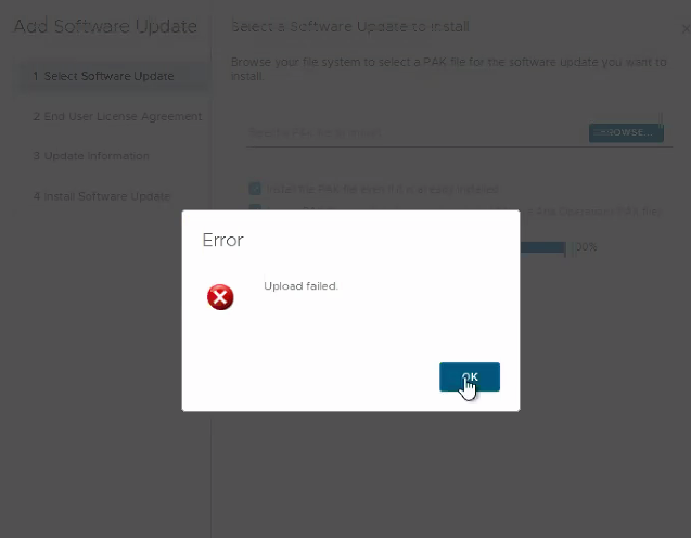

  1. When attempting to upgrade VMware Aria Operations from 8.18.6 to 8.18.7, the installation fails during the .pak file upload phase.
  2. An "upload failed" error message is consistently displayed across different web browsers, completely blocking the UI-based installation process.
