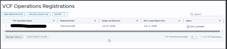

In the UI, the VCF Operations license shows as expired, even though the license in vCenter and on the Support Portal correctly displays as active. Additionally, you may notice a discrepancy in the UI regarding the Reporting Mode; the main Registration details page may show the status as "Connected," while the VCF Operations Registrations list displays it as "Disconnected," and attempts to toggle the modes do not resolve the mismatch.

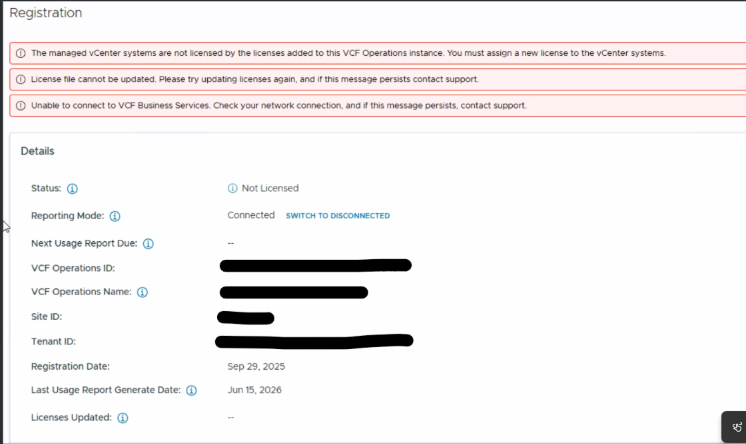

Additionally, you may encounter the following error messages under VCF Operations > License Management > Registration (as shown in the screenshots below):
The managed vCenter systems are not licensed by the licenses added to this VCF Operations instance. You must assign a new license to the vCenter systems.
License file cannot be updated. Please try updating licenses again, and if this message persists contact support
Unable to connect to VCF Business Services. Check your network connection, and if this message persists, contact support
