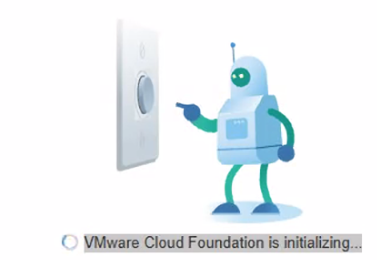

The VCF 9.1 Installer showed that the SDDC Manager deployment completed successfully, but the SDDC Manager UI failed to load with a VMware Cloud Foundation is initializing message.

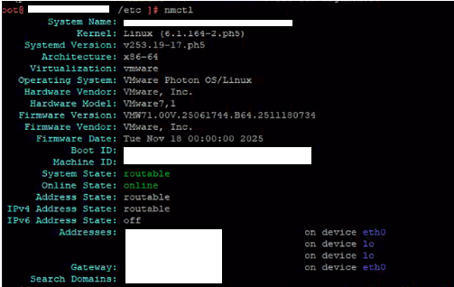

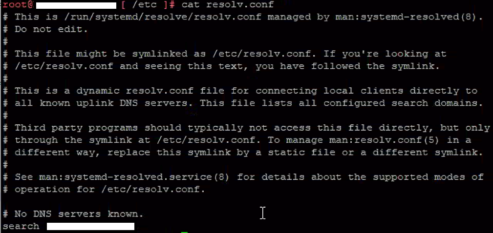

  • /etc/resolv.conf is missing nameserver entries.
  • Running nmctl shows network configuration, but no DNS servers.

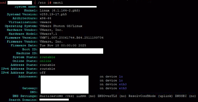

    /usr/bin/nmctl set-dns dev eth0 dns <DNS-IP-1>,<DNS-IP-2>
  3. Verify that /etc/resolv.conf now contains the correct nameserver entries.
  4. Verify that nmctl now displays the DNS servers.
