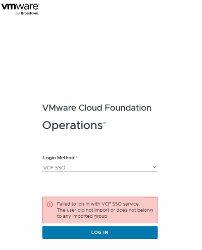

1. You have configured Microsoft Entra ID with VCF SSO by following Configure Microsoft Entra ID as an Identity Provider Using SAML and encounter the following error why trying to log in VCF Operations through VCF SSO.
Failed to log in with VCF SSO service. The user did not import or does not belong to any imported group.

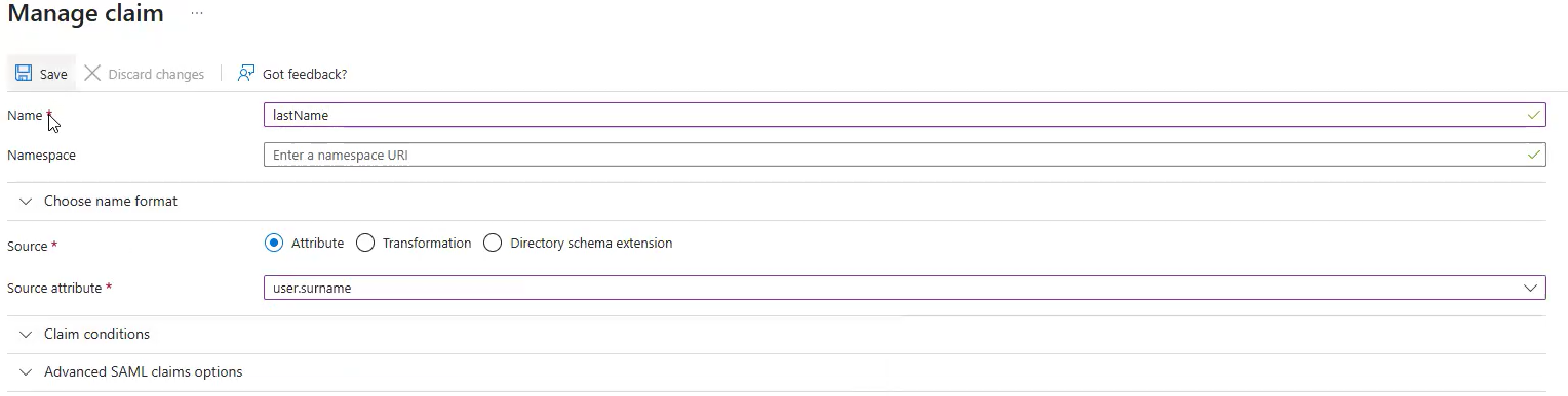

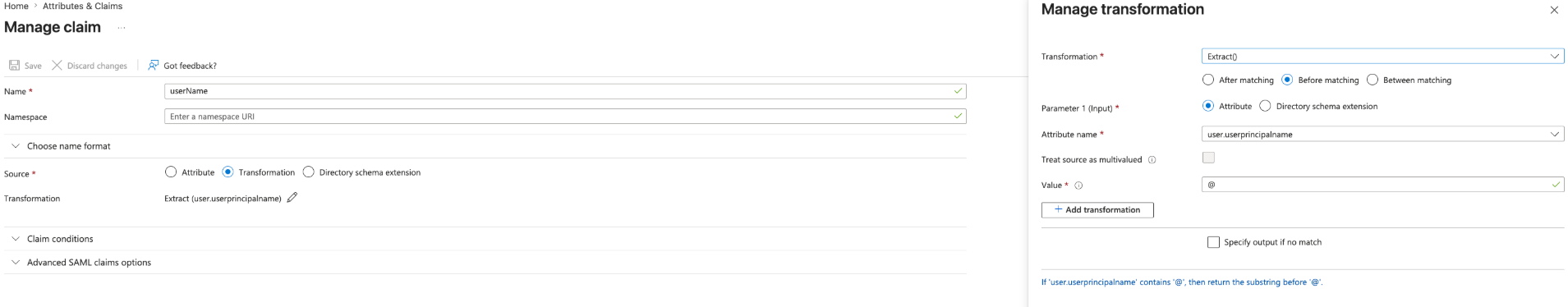

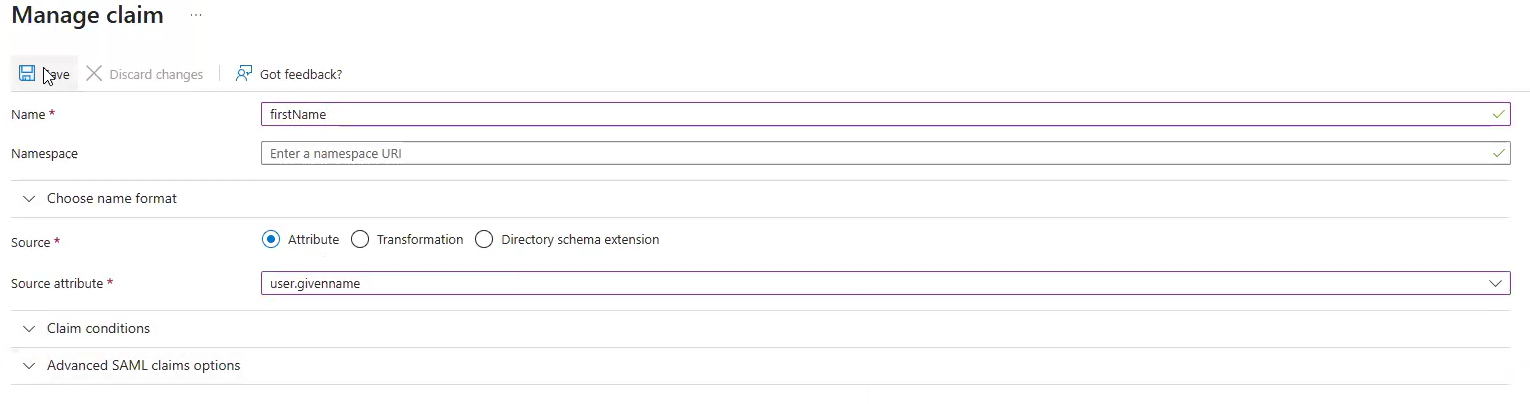

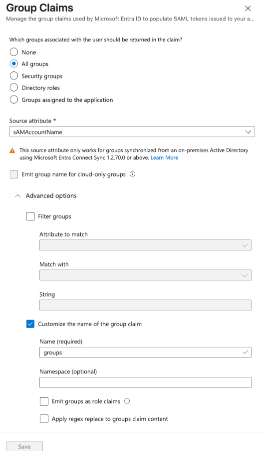

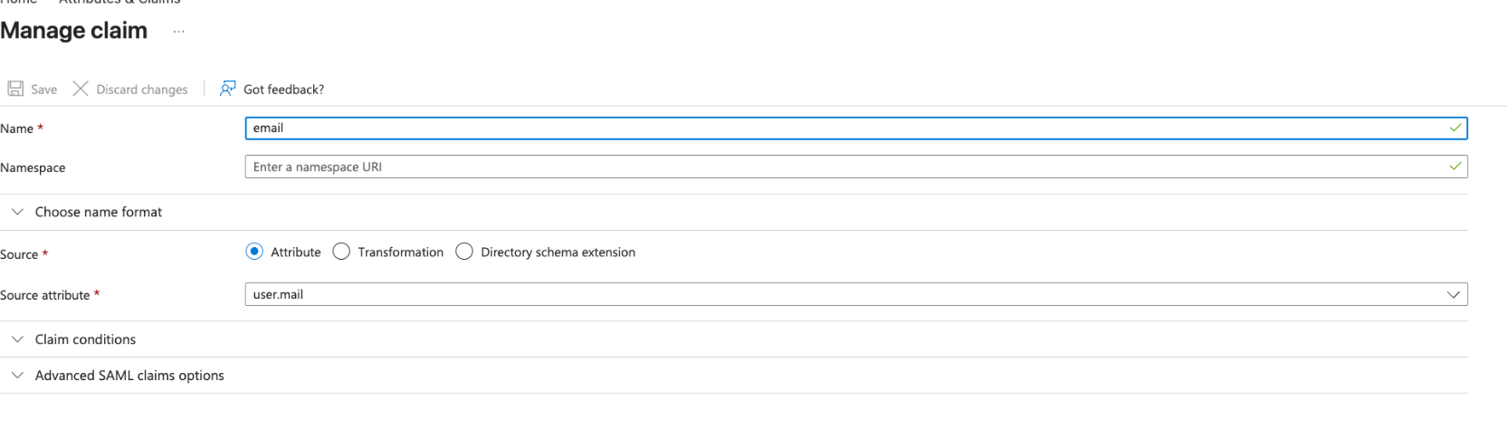

1. In VCF Operations UI > Fleet Management > Identity & Access > VCF Instance > Identity Source > Domain(s) and Group(s), delete the domain that is not needed.

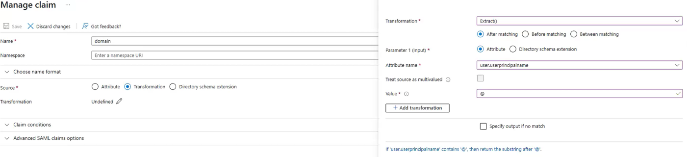

2. In Entra ID UI > Enterprise Appliacations > Single sign-on > Attributes& Claims, make sure the following Attributes & Claims are configured as shown in the screenshots.
Claim NameSource AttributeTransformation / Notes
userNameuser.userprincipalnameExtract(): Before matching @
emailuser.mailDirect attribute mapping
domainuser.userprincipalnameExtract(): After matching @
firstNameuser.givennameDirect attribute mapping
lastNameuser.surnameDirect attribute mapping
groupsuser.groupsGroup Claim: Select 'All Groups'; Source attribute: sAMAccountName
