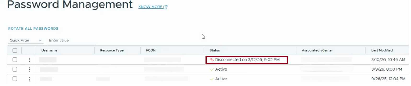

  • In the SDDC Manager UI, the Password Management section displays a "Disconnected" status for Workspace ONE (WS1)/vIDM  admin account.
  • Attempts to remediate or update the password via SDDC Manager fail with credential errors.

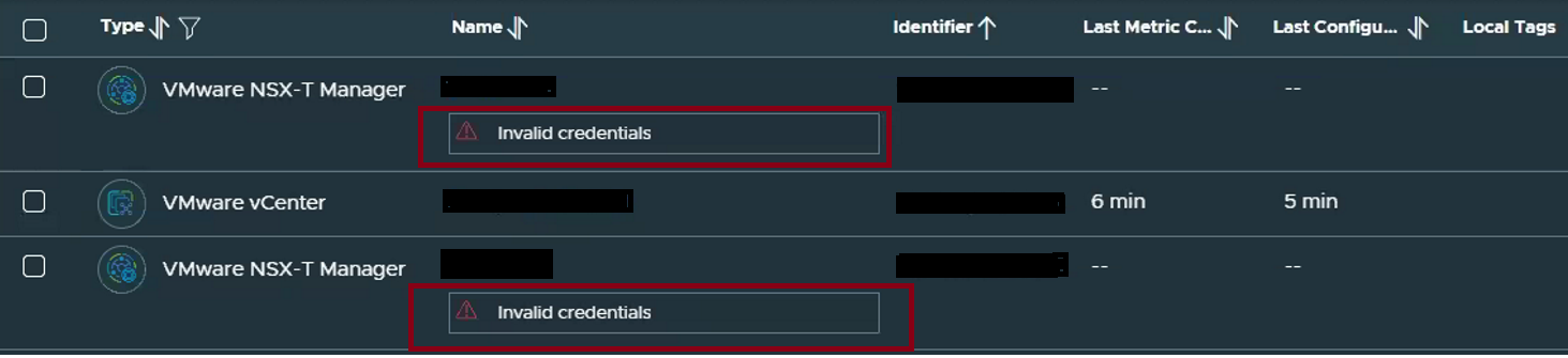

  • Aria Operations for Networks shows "Invalid credentials" status for the NSX-T data sources.

  2. Update Aria Operations for Networks Data Sources
    • Log in to the Aria Operations for Networks UI.
    • Navigate to Settings > Accounts and Data sources.
    • Locate the NSX-T Manager data sources.
    • Edit each data source and enter the newly rotated password
    • Click Submit to save the condifuration.
  3. Remediate SDDC Manager Status
    • Once Aria Operations for Networks is using the correct credentials, return to the SDDC Manager UI.
    • Navigate to Password Management.
    • Select the affected component and click Remediate or Retry to refresh the account status.
    • The admin account should now reflect a "Connected" status.

Aria Operations for Networks is showing 'Invalid credentials' for NSX managers
