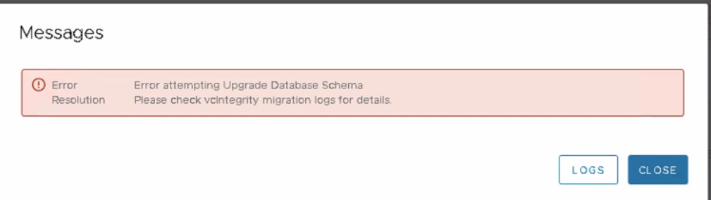

  • Upgrade of vCenter Server to 9.x may encounter a critical failure during Stage 2 (Data Migration/Transfer). This failure halts the migration of the Update Manager (VUM) or vSphere Lifecycle Manager (vLCM) database schema.
  • Upgrade fails during the IMPORT phase with: Error attempting Upgrade Database Schema.
