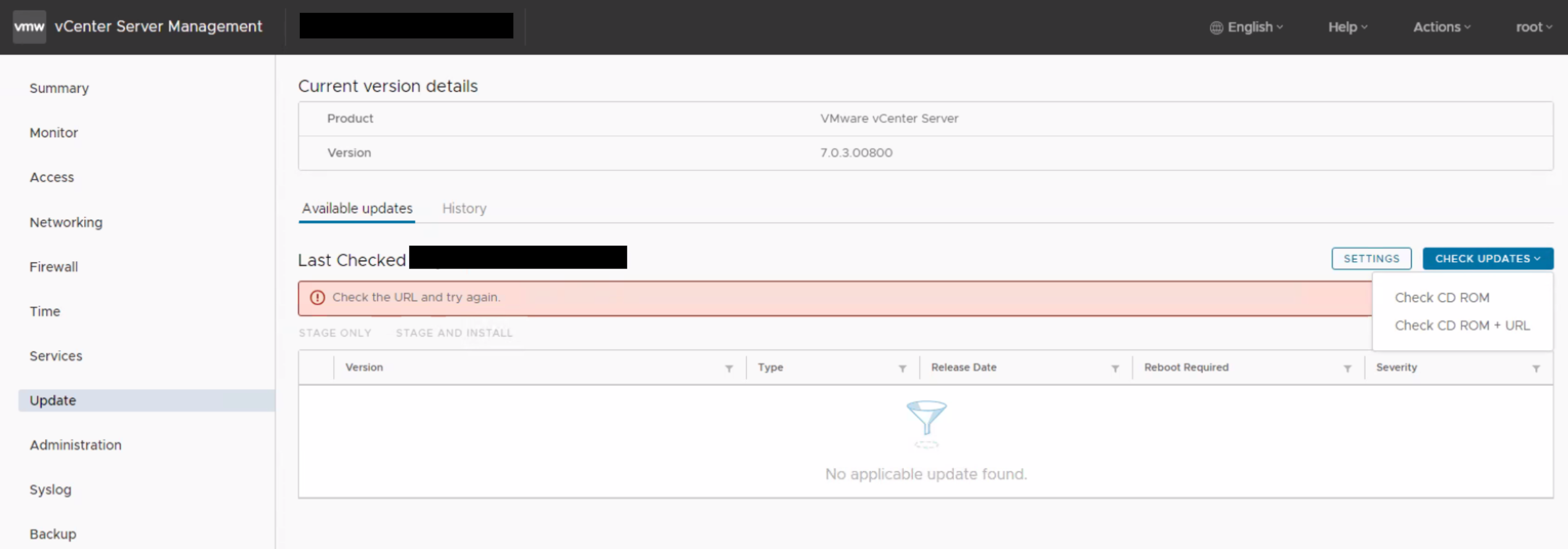

  • vCenter VAMI (https://<vcenter_server_fqdn_or_IP>:5480) > Update > "Check Updates" tab shows any of following error messages:
    • "The vCenter Server is not able to reach the specified URL. Ensure that the vCenter Server is connected to the internet, the specified URL is correct, and the latest version(s) is available on the VMware online repository. If the issue persists, please contact VMware Support."
    • "Check the URL and try again"
    • "Authentication failure. Enter a valid user name and password and try again."
    • "Network failure. Check the network settings and try again."

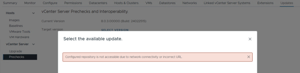

  • In addition the Update Planner in vSphere Client (https://<vcenter_fqdn_or_IP>/ui) shows a connection error:
    • "Configured repository is not accessible due to network connectivity or incorrect URL. Verify the repository settings."
  • Error seen from vCenter:
    In vCenter Server 8.x, the same error is seen in the Prechecks tab (vCenter > Updates > Prechecks):
