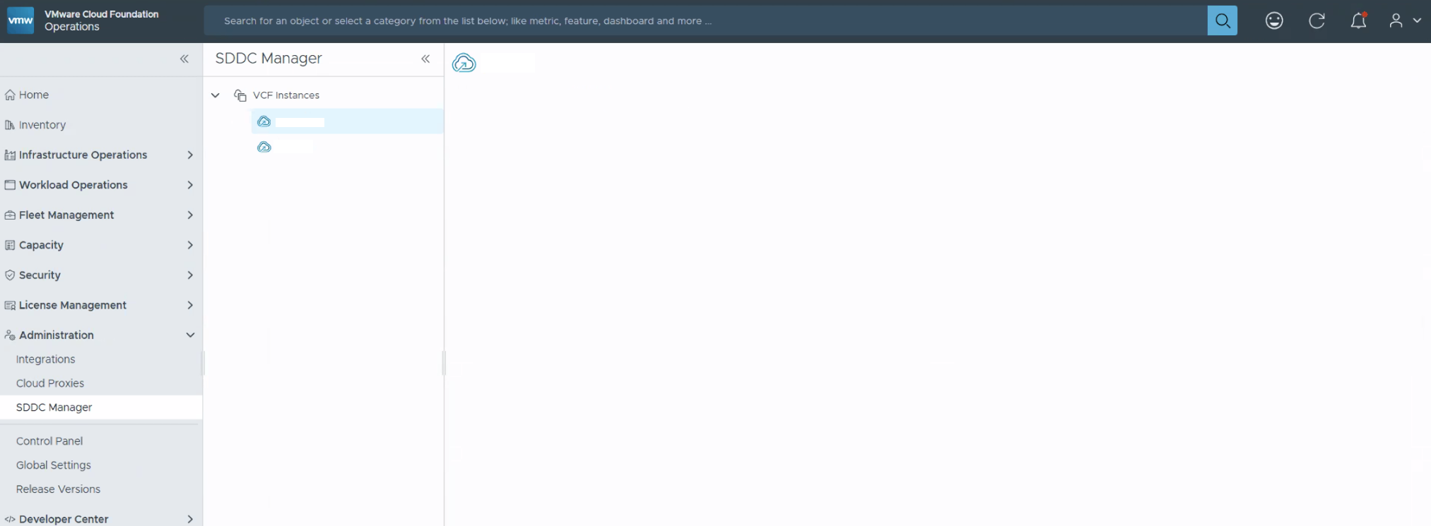

In the VCF Operations UI, the SDDC Manager tile (under Administration) only loads a blank white screen.
