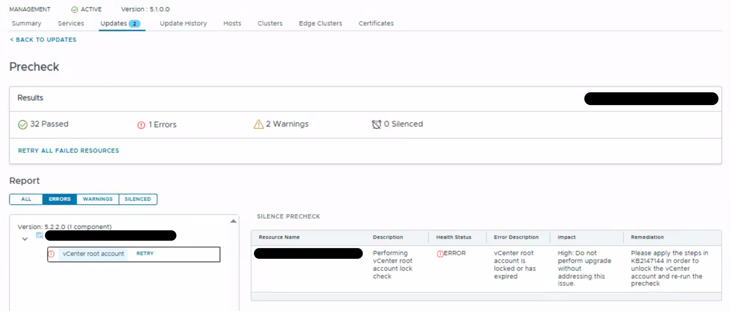

In SDDC Manager, upgrade precheck fails when Performing vCenter root account lock check.
Fails with the error: vCenter root account is locked or has expired
