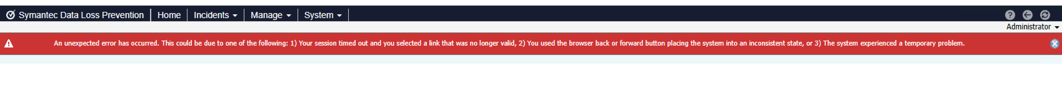

When attempting to issue a 'Change Server' command to a list of Endpoint Agents or a specific Agent, an unexpected error is thrown.

17 Dec 2024 14:13:14,105- Thread: 122 SEVERE [com.vontu.manager] [/AgentTroubleshooting] Unexpected error occurred while processing action
