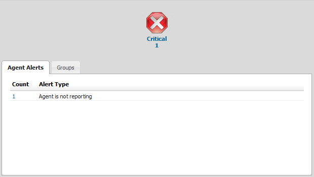

Endpoint Agents are not Reporting into the Enforce Console
Any
The most common cause of this issue is that the Endpoint Agent is pointed to the wrong Endpoint Server.

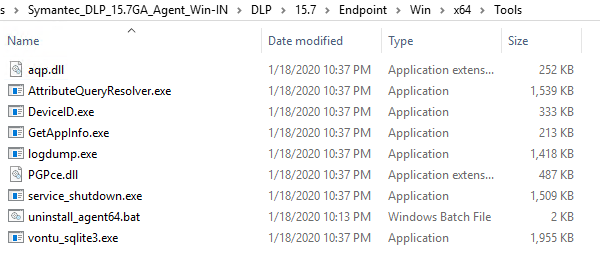

  • Copy the "vontu_sqlite3.exe" tool into the "Endpoint Agent" installation directory
    • Agent Tools can be found in the "Tools" directory from the Agent Package originally downloaded from Symantec.
    • Please also note that if you have to make changes to the Endpoint Server information, you will also need to copy the "service_shutdown.exe" tool.

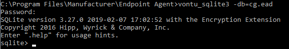

  • Open an Administrative CMD prompt
  • CD to the Endpoint Agent installation location where the tools and .ead files are located.
  • Open the "cg.ead" file using vontu_sqlite3.exe
    • vontu_sqlite3 -db=cg.ead
    • You will be prompted for your Tools password
  • Query the cg.ead file for the server information.
    • SELECT * FROM configuration WHERE name="ServerCommunicator" AND setting="SERVER_HOST_AND_PORT_LIST";
    • We are interested in the IP Address and Port listed, in the above screenshot "192.0.2.2:10443"
    • This tells us what server it is pointed to and what port it is using (default port is 10443).
    • We should compare the IP Address or Hostname to what was seen in Step#2 above from the Endpoint Server, these should match exactly in most scenarios.
    • If these values do not match, then update your agent configuration with the below command...
    • UPDATE configuration SET value="<EndpointServer>:<Port>" WHERE name="ServerCommunicator" AND setting="SERVER_HOST_AND_PORT_LIST";
      • EXAMPLE:UPDATE configuration SET value="192.0.2.2:10443" WHERE name="ServerCommunicator" AND setting="SERVER_HOST_AND_PORT_LIST";
