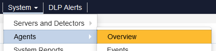

1. Navigate to System -> Agents - Overview
2. In the bottom section of the screen click on "View Summary Reports".

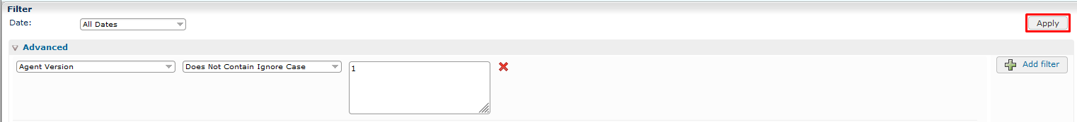

3. On the new Window expand Advanced and click "Add filter".
4. From the drop down menu select "Agent Version", then "Does Not Contain Ignore Case", and into the entry field enter "1" and click on Apply.
5. The result will be a list of agents with an empty version number.
Skip this agent/those agents when adding Endpoint to the targeted device/s in your Endpoint Discover Scan and the save should be successful.
