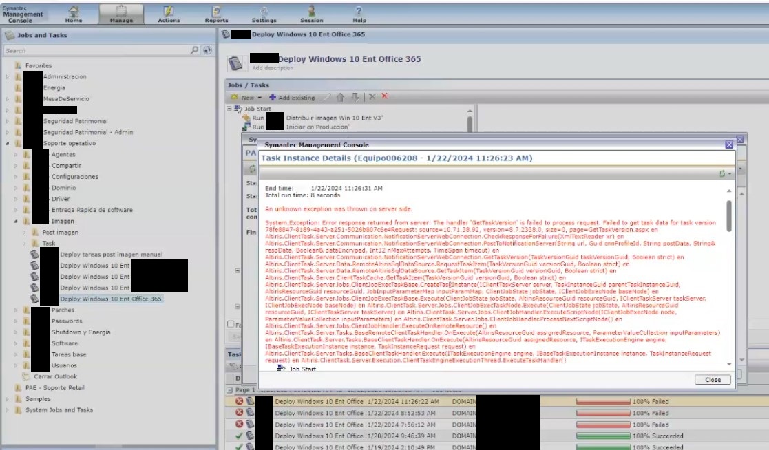

While trying to run a Deployment imaging task, the following error happens when the task is started:
An unknown exception was thrown on server side. System.Exception: Error response returned from server: The handler 'GetTaskVersion' is failed to process request. Failed to get task data for task version 78fe8847-8189-4a43-a251-5026b807c6e4Request: source=10.71.38.92, version=8.7.2338.0, size=0, page=GetTaskVersion.aspx
