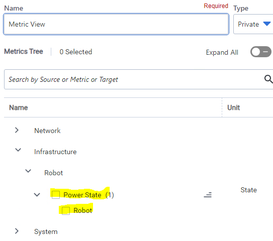

Some robots are missing the Power State metrics in Metrics View.
When we check the DB the hub QOS_POWER_STATE metrics are in RN_* Tables, but they are not showing in Metric viewer.
Other Metrics are working fine.

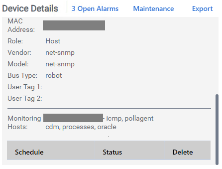

Also noticed that hub probe is missing Monitoring Host section:
