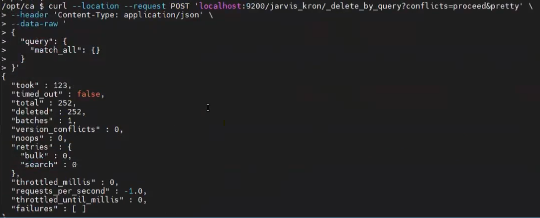

2/ Log into your elastic master pod and run the following postman command from the command line. You should get the result similar to the one below.
kubectl get pods -n<namespace>  | grep jarvis-elastic
kubectl exec -ti -n<namespace> jarvis-elasticsearch-<elastic_pod_id> sh
curl --location --request POST 'localhost:9200/jarvis_kron/_delete_by_query?conflicts=proceed&pretty' \
--header 'Content-Type: application/json' \
--data-raw '
 "query": {
  "match_all": {}
3/ Scale up the 2 specific jarvis services below and wait until these 2 pods are started. The jarvis-kron pod has to be started first.
kubectl scale --replicas=1 deployment jarvis-kron -n<namespace>
kubectl scale --replicas=1 deployment jarvis-esutils -n<namespace>
Wait for 10 minutes and check the jarvis health again. This should become green now.
If the problem persists, open a case with Broadcom Support for assistance and attach to it all the jarvis logs from <nfs-dxi>/jarvis/*
DX AIOps - Jarvis (kafka, zookeeper, elasticSearch) Troubleshooting
EXPLANATION: All the jobs that were done in esutils like rollover functionality, apache and all will get stored in the jarvis-kron. Along with that when you make any health check calls on the jarvis - those also will get recorded in this particular jarvis_kron elasticsearch index. If there is a lot of latency in the system caused by the underlying platform performance issues for example lot of health checks are failing. As a consequence, a huge number of failed health checks are being stored. Any restart of the jarvis_kron pod triggers another health checks that can fail as well. The above query will delete all of these previous jobs being stored in the jarvis_kron elasticsearch index.
