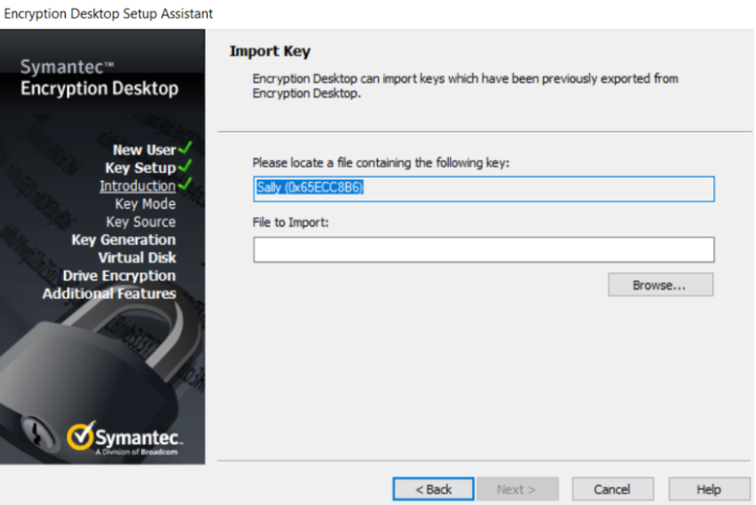

Step 8: On the next system User1 is going to enroll on with this SCKM key, authenticate the enrollment window as you did previously and then you will see the Key Generation Wizard.
When you get this page, make sure you click “Import Key”. This is where you will browse to User1’s keypair that you exported from the previous steps:
As you can see “User1’s” Key shows up in this dialog box as well as the Key ID mentioned and you will notice this matches.  Browse to the keypair on this screen and click Next:
You will need to enter the passphrase for this key to show User1 is authorized to use this key:
