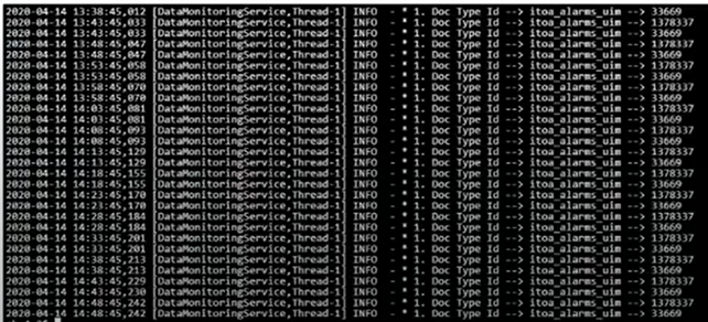

Below screenshots illustrate a use-case where NEW alarms are not being processed: "itoa_alarms_uim count" has been the same for the past 2 days
if we filter the log:
more normalized_alarm.log | grep "itoa_alarms_uim"
Recommendation:
Restart normalized-alarm pod
