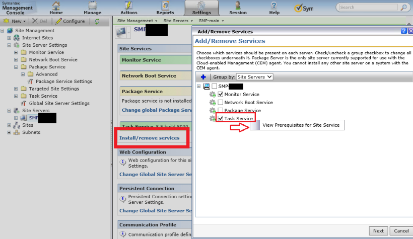

While adding the Task Service in the SMP Console, it will also show you what we are expecting to have setup (if you right-click on Task Service>View Prerequisites for Site Service):
  • Computer managed
  • Local
  • Asset status is active
  • Agent version supported
  • CEM Mode disabled
  • Operating system supported
  • Service not installed
  • IIS configured
  • NET framework version supported
