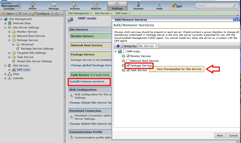

While adding the 'Package Service' in the SMP Console, it will also show you what we are expecting to have setup (if you right-click on Package Service>View Prerequisites for Site Service):
  • Computer managed
  • Local
  • Asset status is active
  • Agent version supported
  • Operating system supported
  • Service not installed
  • HTTP Server installed (In order for packages to be via HTTP/HTTPS, then the IIS must be installed)
