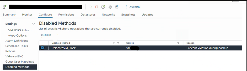

Symptoms:
  • Right-clicking a virtual machine in vCenter Server the Migration and Power-off option is greyed out.
VMware vCenter Server 7.x
VMware vCenter Server 8.x
This issue can occur after a virtual machine backup completes and the entries from the vCenter Server database vpx_disabled_methods table are not removed.

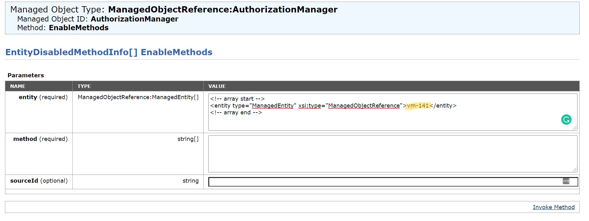

  1. ​​​​​​Access the Virtual Machine Operations by opening a web browser to:
https://ExamplevCenterFQDNorIP/mob/?moid=AuthorizationManager&method=enableMethods
  1. Login with administrator@yourssodomain.local or an SSO admin user.
For example: [email protected]
  1. The below page will appear:
  1. In the first parameter entity value box, replace MOID with the VM's MOB ID
For example:
<!-- array start -->
<entity type="ManagedEntity" xsi:type="ManagedObjectReference">vm-141</entity>
<!-- array end -->

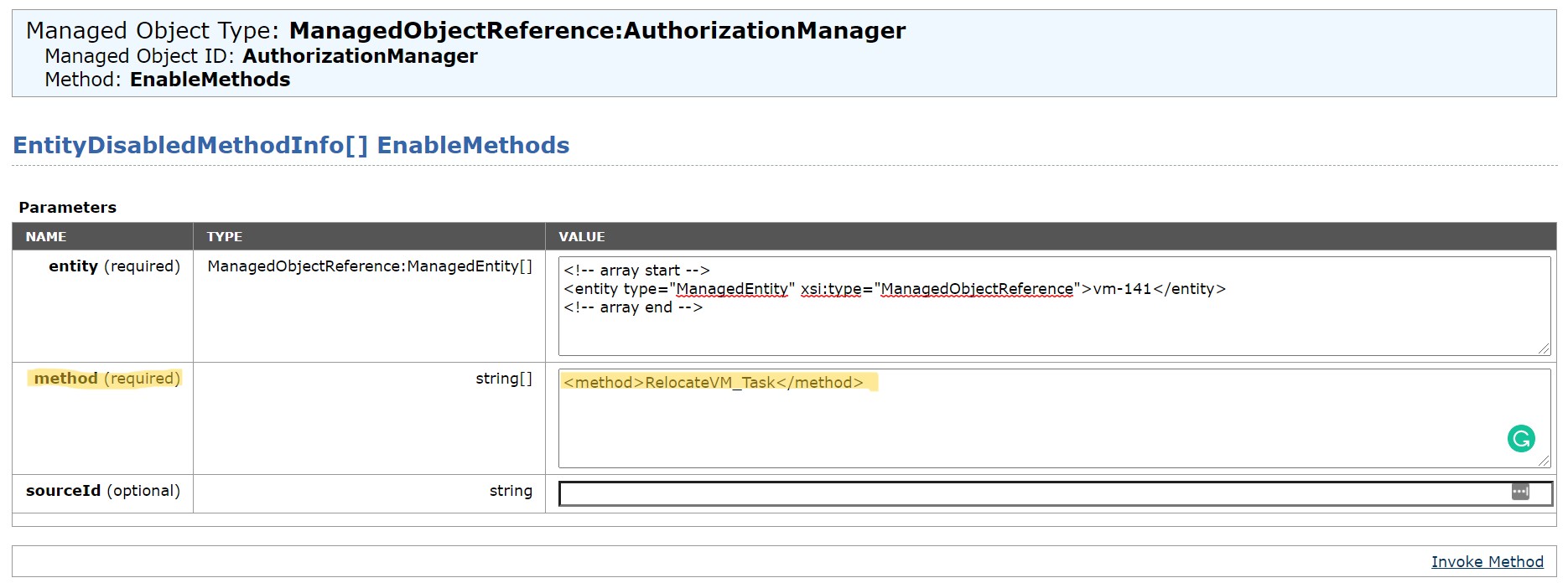

  1. In the second parameter entity value box, enter this command:
<method>RelocateVM_Task</method>
  1. Click on Invoke Method
  1. Refresh the vCenter Server web client and the migration option for the VM should now be available. If the issues persist:
