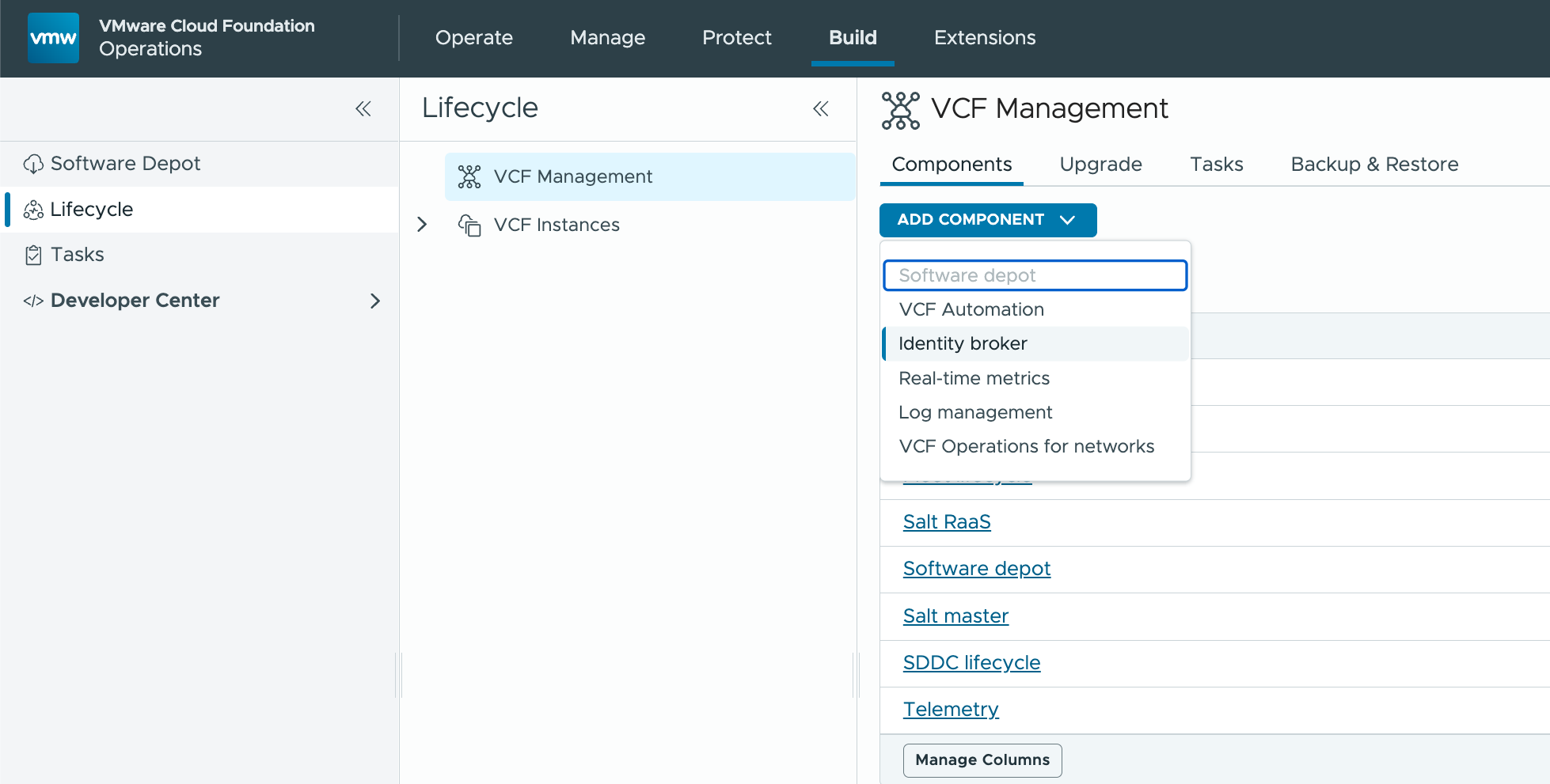

  • VCF Operations Build → Lifecycle → VCF Management→ Components tab shows a warning panel with a list of components that failed to be added to Fleet lifecycle, each linking to the corresponding task detail
    Main Warning Box:
    1 warning
    mgmt: The following components are blocked from being upgraded to 9.1 because they failed to be added to fleet lifecycle. Click each component to view the error and remediation information.
    • VCF Operations for networks
    • Log management
  • The task details link shows the cause of the failure and a link to this KB article for remediation steps.

  • If Fleet Lifecycle is at version 9.1.0.x: The script submits the add component request to Fleet Lifecyle for each component that passes all checks.
  • If Fleet Lifecycle is at version 9.1.1.x or later: You can either use this script to add the components to Fleet lifecycle, or use the Add Component workflow in the Fleet lifecycle UI.
