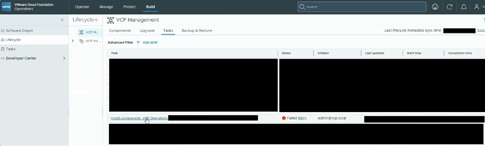

  • Upgrading  VCF 9.0.x environment to 9.1.0.0 /9.1.1.0 fails when trying to "Import VCF Operations in Fleet Lifecycle"

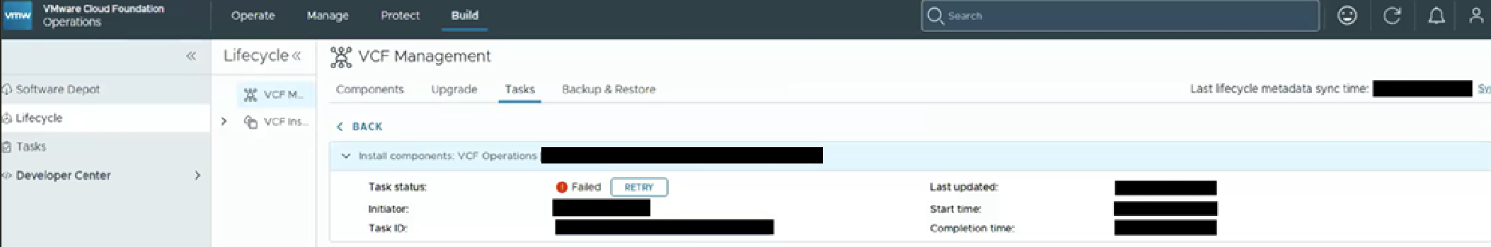

  • The Fleet lifecycle 'Component import' task fails with errors such as:
    Message: The Fleet lifecycle 'Component import' task with ID <task id> failed. Internal errors: An unexpected error occurred in step discover_vrni_component_task_ref. Reference Code: 6F30FB09. Please contact support with this reference code.
     Detail: I/O error on POST request for "https://<IP>:443/api/auth/login": Certificate for <IP> doesn't match any of the subject alternative names: []
  • The "Install components using SDDC lifecycle service" task fails with:
    Unable to register components with VCF Operations.

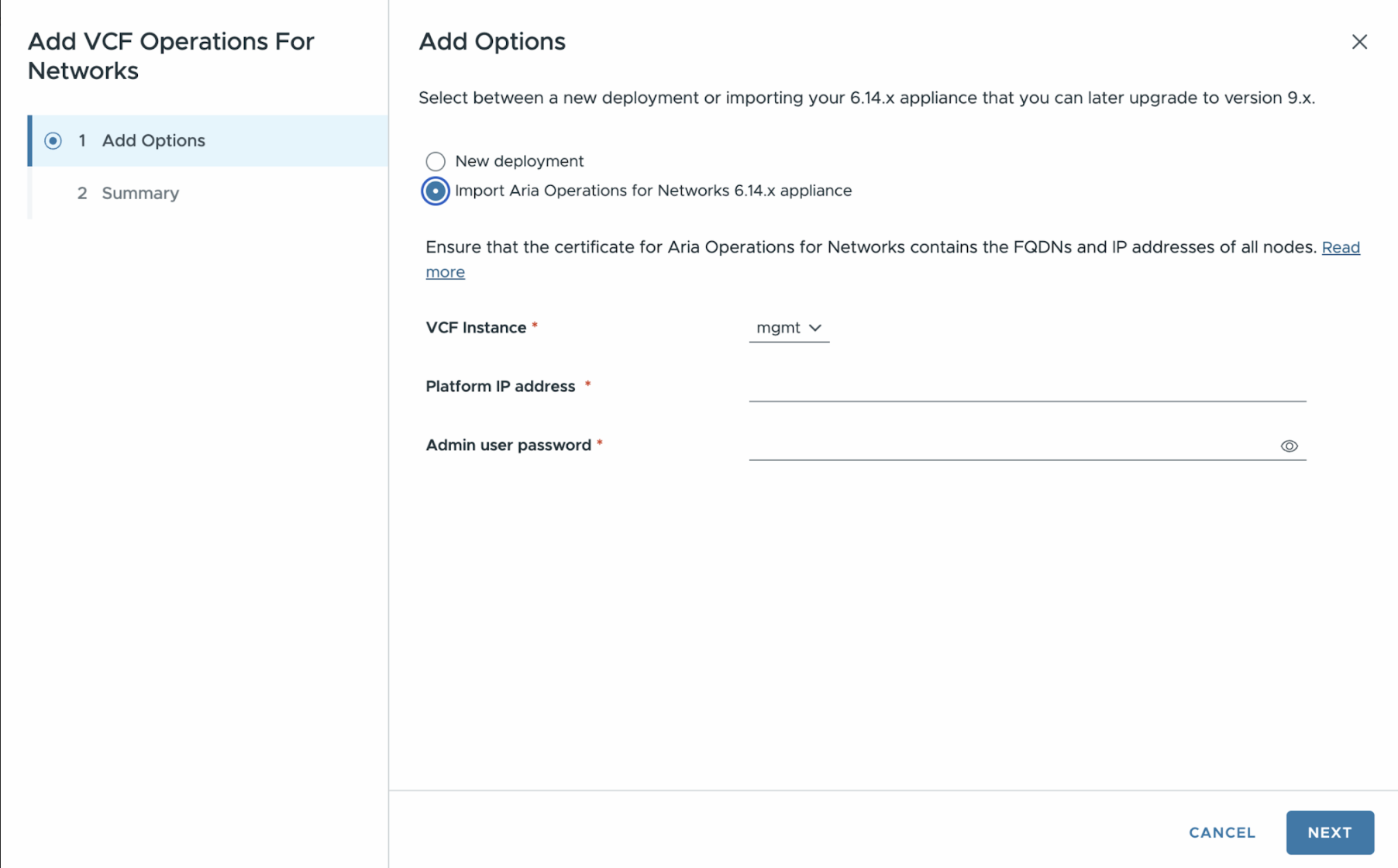

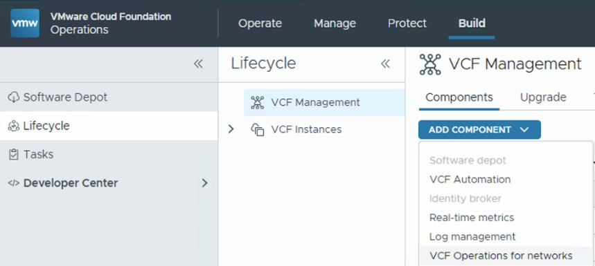

  1. Use the script attached to "Deploy VCF Management Components" task fails during "Import VCF Operations in Fleet Lifecycle" to clear stale legacy data from VCF Operations (Option 1). When the script has successfully completed its execution, the Deploy VCF Management Components task (VCF Operations UI > Build > Tasks) will be restarted in the VCF Operations UI.
  2. When the task is completed successfully, re-run the script attached to "Deploy VCF Management Components" task fails during "Import VCF Operations in Fleet Lifecycle" to import the VCF Operations for Networks component (Option 2). This will fail with a similar certificate error and a message stating to use this KB article will be displayed.
