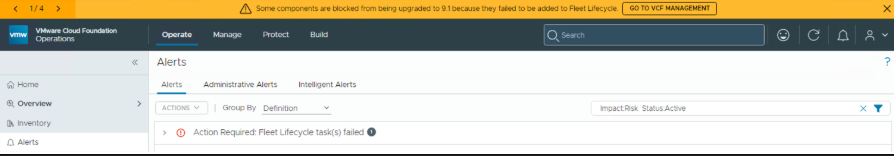

  • VCF Operations UI will display banner to prompt users to go to VCF Management tab, as some components are blocked from being upgraded
    Top Notification Banner:
    "Some components are blocked from being upgraded to 9.1 because they failed to be added to Fleet Lifecycle. GO TO VCF MANAGEMENT"

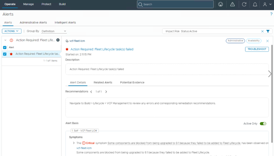

  • VCF Operations UI will report an alert for user attention
    Alert Name:
    Action Required: Fleet Lifecycle task(s) failed
    Symptom:
    The Critical symptom Some components are blocked from being upgraded to 9.1 because they failed to be added to Fleet Lifecycle. has been observed on vcf-fleet-lcm
    (Note: Cancelling this alert from the VCF Operations Alerts panel dismisses both the top warning banner (example 1 above) and the VCF Management warning panel (example 3 below)

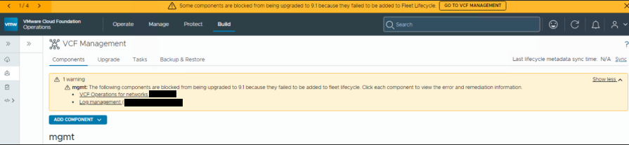

  • VCF Operations Build Lifecycle VCF Management Components tab shows a warning panel with a list of components that failed to be added to Fleet lifecycle, each linking to the corresponding task detail
    Main Warning Box:
    1 warning
    mgmt: The following components are blocked from being upgraded to 9.1 because they failed to be added to fleet lifecycle. Click each component to view the error and remediation information.
    • VCF Operations for networks
    • Log management

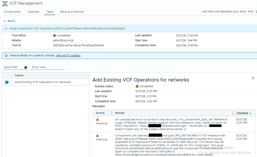

  • The task details link shows the cause of the failure and a link to this KB article for remediation steps.
    An unexpected error occurred in step discover_vrni_component_task_ref. Reference Code: 127B3D16. Please contact support with this reference code. Detail: I/O error on POST request for "https://[redacted]:443/api/auth/login": Certificate for <[redacted]> doesn't match any of the subject alternative names: []

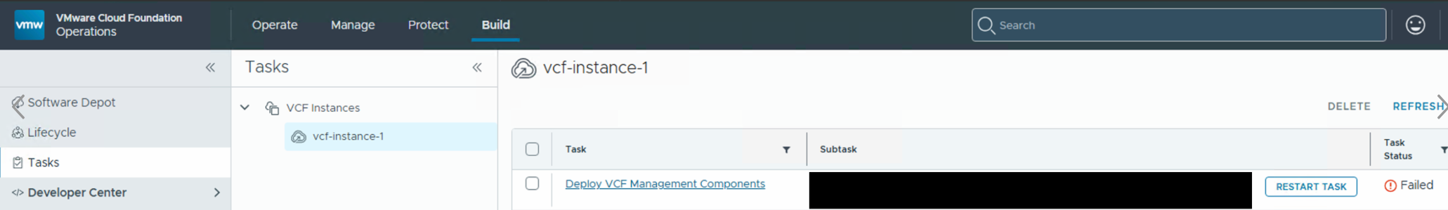

After "Deploy VCF Management Component" workflow completes, it will be in a Failed state as shown below.
  1. Upgrade failure in the VCF Operations UI:
    Within Build > Tasks > VCF Instances: The Task: Deploy VCF Management Components the Task Status column shows Failed

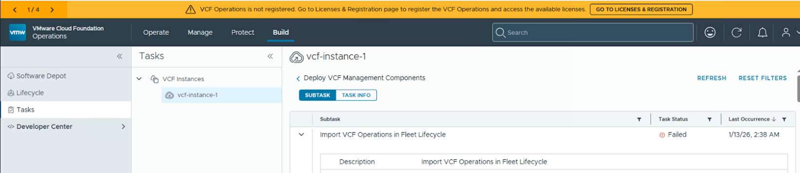

  2. Example of the failed Import task in the VCF Operations UI:
    Within Build > Tasks > VCF Instances > click Deploy VCF Management Components: The  Import VCF Operations in Fleet Lifecycle subtask Task Status column shows Failed
