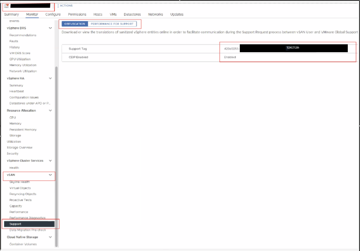

Note: The string of alphanumeric characters before the ':' and not highlighted is the Vc-Uuid and also aligns to the Config Generation in the vSAN cluster get output as seen below in the next step. The string of alphanumeric characters after the ':' is the vSAN cluster UUID and should align with the Sub-Cluster UUID as seen in the below vSAN cluster get output.
vSub-Cluster UUID: 5250e5de-7689-0f8e-6896-############52417139-b5b4-e630-a8f8-###########

To fix this and get the vSAN cluster UUID in sync between vCenter and ESXi do the following:
SSH to the vCenter appliance and login as "root".
Stop the vpxd service by running service-control --stop vpxd
Run /opt/vmware/vpostgres/current/bin/psql -d VCDB -U postgres to access the postgres database. Refer the instructions on KB Interacting with the vCenter Server Appliance 6.5/6.7/7.0 embedded vPostgres Database
Then run SELECT id,vsan_uuid FROM vpx_compute_resource; to get a list of all the vSAN clusters.
VCDB=# SELECT id,vsan_uuid FROM vpx_compute_resource;----+-------------------------------------- 21 | 52417139-b5b4-e630-a8f8-xxxxxxxxxxxx(1 row).Then run "SELECT * FROM vpx_compute_resource_vsan_host WHERE cluster_uuid='<vSAN Cluster UUID as seen in vCenter Web Client>' order by host_id;" to see all the hosts associated with the cluster_uuid you want to view.
For example: SELECT * FROM vpx_compute_resource_vsan_host WHERE cluster_uuid='52417139-b5b4-e630-a8f8-xxxxxxxxxxxx' order by host_id;
Re-initiate the OVF deployment. The OVF should now deploy successfully to the vSAN datastore without any errors.
