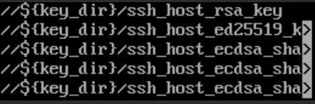

  • Edit the sshd_config_effective file and locate the 'HostKey' entries.
  • Update all the 'HostKey' entries from //${key_dir}/ to /etc/ssh/keys/v2.
    From:
TO:
  • Save the file and reboot the node.
