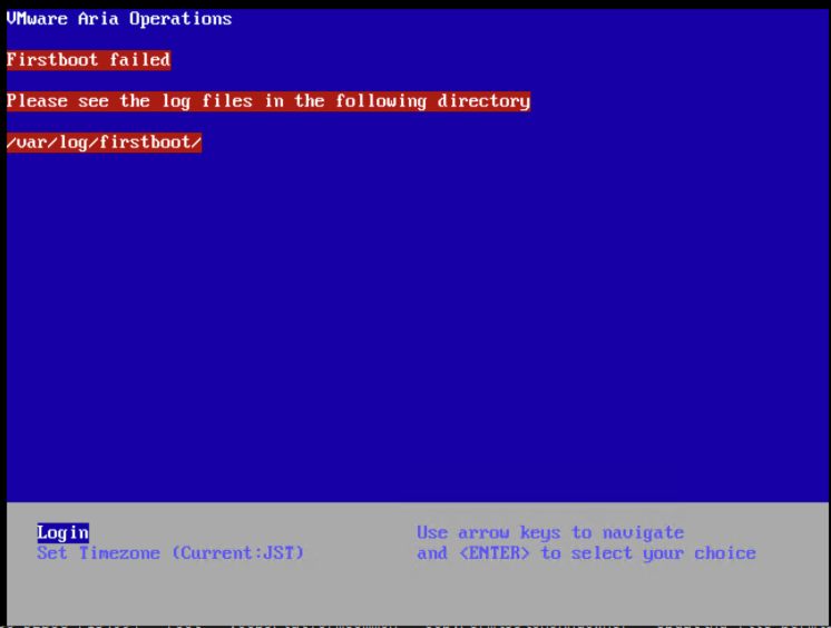

  • During an upgrade of Aria Operations, the VMs are rebooted. After the reboot, the console of the VM shows the below 'Firstboot failed' error and the GUI(both /ui and /admin) becomes inaccessible.
  • The following error is displayed on the VMs console screen:
    Firstboot failed
    Please see the log files in the following directory
    /var/log/firstboot/
