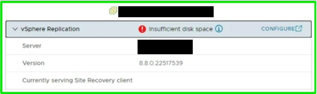

Symptoms:
  • vSphere Replication will occasionally report low disk space or insufficient disk space when the log partition fills up.
  • This disk exhaustion may lead to widespread RPO violations as the appliance lacks the necessary buffer space to process replication metadata and write operation logs.

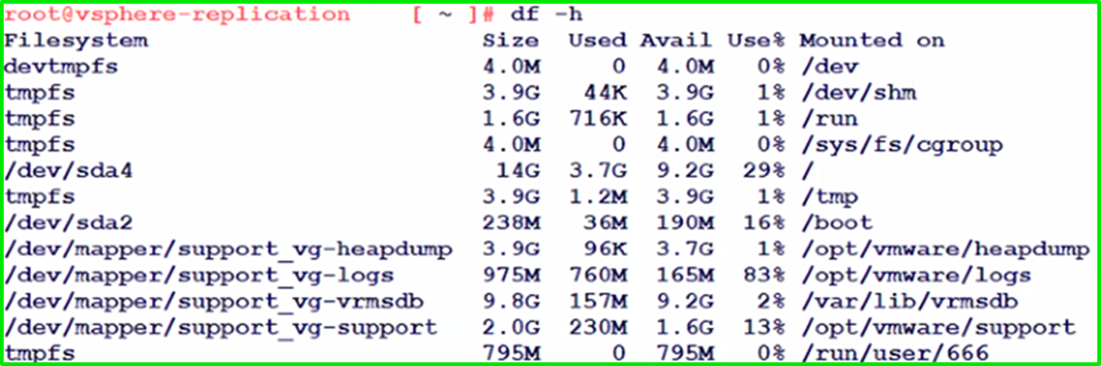

  • Check the file usage in the appliance by running the df -h command.
Example as below.

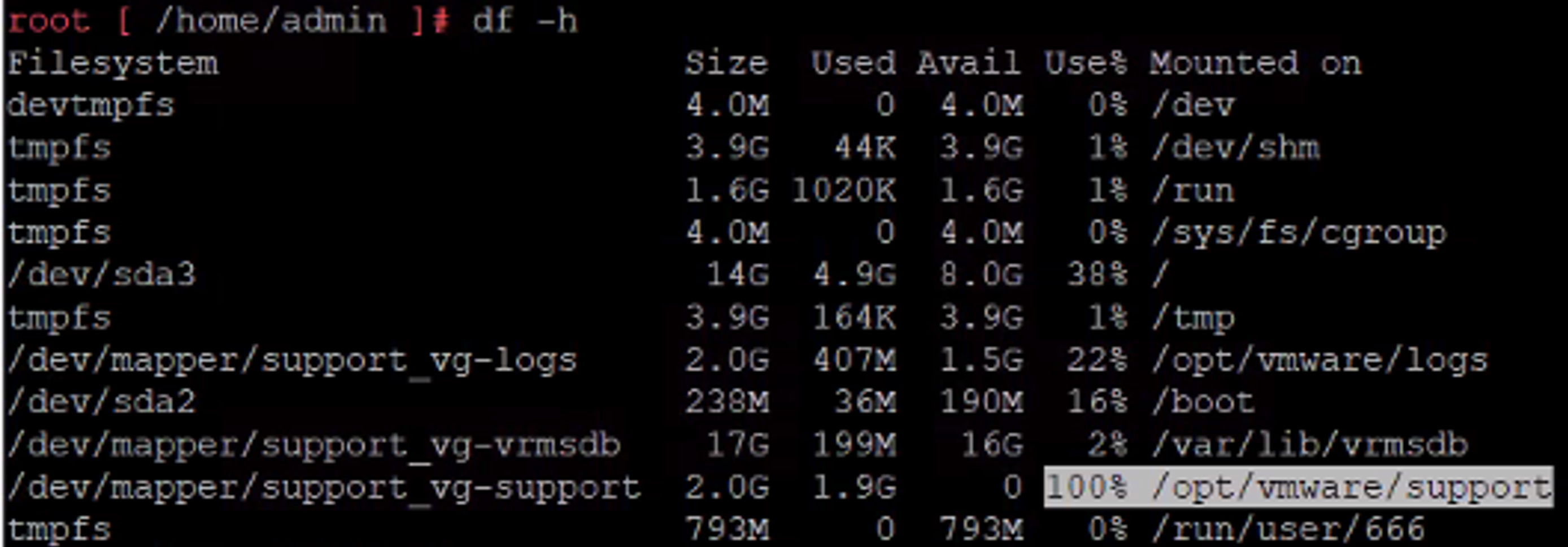

  • Reboot the appliance and check the disk space now to see how much space has been released.
Example as below.
