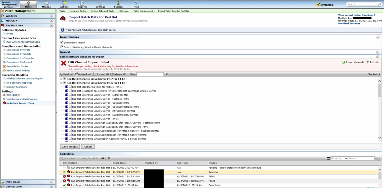

Getting: Channel import failed, check Altiris Log for detailed information

Investigate why the Notification Server can't connect to https://subscription.rhn.redhat.com/subscription via SSL.
When the option to download RHEL 6 patch metadata is selected, the daily import job fails. The admin has extended support for RHEL 6 through Red Hat and has access to any new patches.
The RedHat 6 extended support channel import is failing:
In the NS logs we can see some warnings complaining about registering to RedHat right after verifying subscription:

ITMS 8.6 RU1
Based on the NS logs, we have the following problem:
When the Import task was trying to update the expired certificate, it could not connect to Red Hat using SSL protocol.
