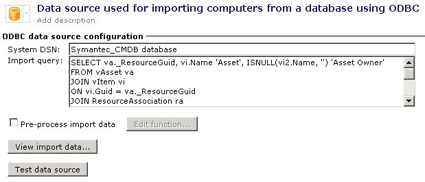

- Click on the "View import data" button to view the data from the import query. If an error for the System DSN occurs, such as "Unable to get data from the selected data source.", ensure that its name is entered correctly in step 5. If an error occurs for the import query or if the data doesn't appear as expected, correct the name or custom import query until the expected data is present.
- Click on the "Save changes" button. The data source should now look similar to the following example:
