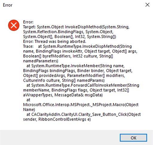

Actual Results: A target error that starts with "Target: System.Object InvokeDispMethod (System.String, System.Reflection.BindingFlags, System.Object"  referencing: "Error: Thread was being aborted" and the project remains locked in Clarity.
Screenshot of error below:
